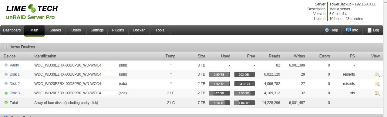

Testing on beta14 -no plugins -no docker -no notifications -no VM's
After the 15minutes disk1 and 2 did spin down but disk3 is still spinning - syslog shows that all three drives received the spindown command.
