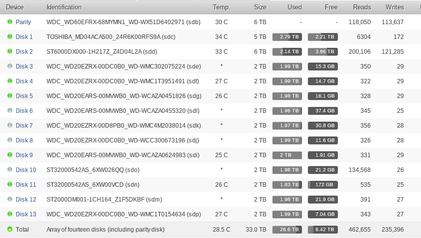

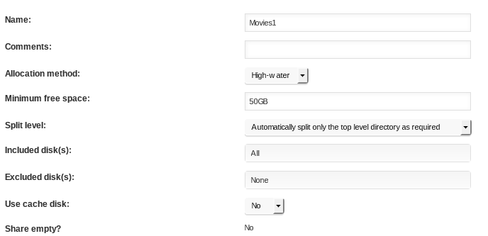

active dockers: Plex
plug-ins installed: Powerdown, Snap (nothing connected), Dynamix System Statistics, Dynamix System Information, Dynamix webGui, Dynamix Active Streams
1 share includes all array disks (see pic for settings).
No rhyme or reason as to which drive stays awake other than the 3 I expect to be up. I would expect 1 & 2 to be active (and cache) as they are the only ones with space left for writes. Currently running Plex cloud sync from title on disk 2. Note disk 10 shows traffic but that is from yesterday when I cloud sync'd an older title. The rest have no business being awake.
