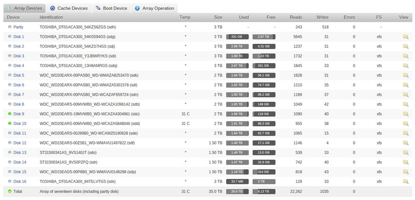

Last two days, it has come back. Here are my drive models using Weebotech's command experiencing the problem:
lrwxrwxrwx 1 root root  9 Dec  2 10:20 ata-WDC_WD20EARX-00PASB0_WD-<SNremoved> -> ../../sdf
lrwxrwxrwx 1 root root  9 Dec  2 10:20 ata-WDC_WD20EARS-00MVWB0_WD-<SNremoved> -> ../../sdc
I initially only noticed it on the sdf device (disk 1 for me, sdc is disk 2).
Checked lsof and no open files on those drives. I have plex, but it is outside the array on a cache drive (along with all my other dockers). No cache_dirs.
Appears to have tried to spin them down about an hour ago:
Dec 9 08:59:26 Tower kernel: mdcmd (184): spindown 1
Dec 9 08:59:57 Tower kernel: mdcmd (185): spindown 2
Edit: adding in smartctl output:

All my WDC_WD20EARX are not spinning down
hdparm -C /dev/sdd =  drive state is:  active/idle
/usr/sbin/smartctl -n standby -A /dev/sd? will yield the same type of output as below.
