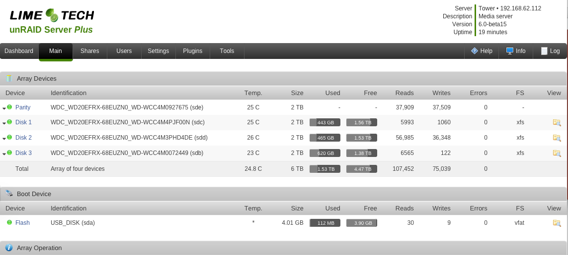

OK, I have read through the instructions several times and it all makes perfect sense.  I have five data disks in my array and a parity disk.  Disk 5 was recently added (formatted as RFS) and is empty. All five data disks are 3TB WD Reds.  I have formatted Disk 5 (it was empty as I had not added it to a user share yet) with XFS and am copying the contents of Disk 1 to Disk 5 as per instructions.  My planned migration is like this since all disks are identical in size:
Disk 1 ---> Disk 5
Format disk 1 XFS
Disk 2 --> Disk 1
Format disk 2 XFS
Disk 3 --> Disk 2
Format disk 3 XFS
Disk 4 --> Disk 3
Format Disk 4 XFS
Disk 4 then becomes the extra disk I can add to user shares as needed.
My question is what does this do to user shares where I have the current disk 1 ... disk 4 assigned to the shares?  Do I need to unassign the disks and reassign the "new Disk 1 (Disk 5)" as Disk 1, etc. after the changes?  As you can see, I am not 100% certain about how physical disks, array disk assignments and user shares that use these disk are all related after making these changes.  Of course, initial array configuration and share creation all makes perfect sense, but, I am unclear on what happens when contents are moved from one disk to another after changing file system.
If you have allowed the User Shares to use all disks, then you do not have to do anything else.
If you have restricted and shares to only use specific disks, then afterwards you should change the share settings to match your new layout.
OK, thanks.  I have several shares restricted to certain disks and one that uses all current data disks.  For example, I have a Pictures share that uses all the current data disks (disk1 - disk4).  After the changes, would I need to set that to disk1, disk2, disk3, disk 5?
I have a Videos share that uses disk2, disk3, disk4 so that would require a change to disk1, disk2, disk3, correct?  And so on with all shares where the contents have moved to different physical disks?
EDIT:  Perhaps the easiest thing to do would be to change all shares to use all disks (at least the larger ones that already span multiple disks).
There's one other option, do a New Config when you are all done converting, and re-assign all drives to their original slots, then you can either rebuild parity (optionally without the empty drive), or mark it as already valid (but good to run a parity check anyway).  The actual data will be on physically different drives, but the same disk numbers, so share configuration will still be correct.  Your choice, but the quickest would be what you added by your edit.
It's important to understand that user shares only loosely obey their configurations. For example, if you had a share using disks 1-3, and during migration those drives became disk5, disk1, disk2 (without changing the setting), the files on disk5 would continue to be shown as part of the share, but would not receive any new files, disk3 could start receiving new files, and disks 1 and 2 would work as expected.
