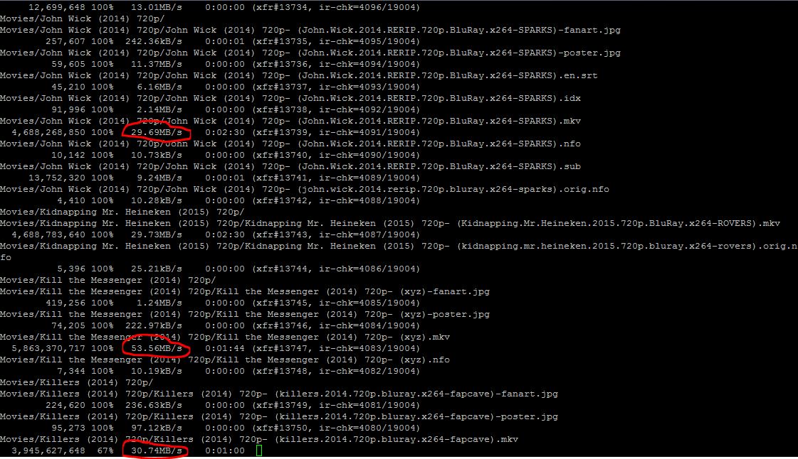

I am using rsync -av without the remove source files the first time, and will do that option the second time as it is supposed to be much quicker and less of a chance to get a red ball or corrupt files.
I did notice something strange, though. While transferring the big files, some files transfer at 29-30MB/s and some transfer at 55MB/s. Nothing in between. I don't get why there is a difference. See the attached screenshot. I guess about two thirds of the big files go at 29 and about a third go at 55. Any ideas? I am really curious.
Thanks
PS. I am transferring from a 2TB drive that was almost full (55GB free) to a 3TB drive. My parity is a 3TB drive and all other existing drives are 2TB or smaller.
