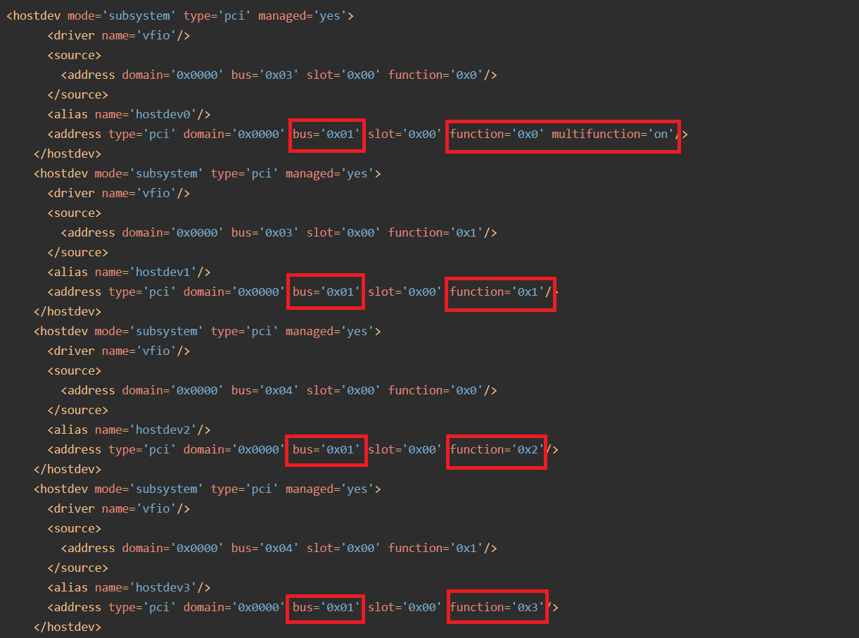

Hi all,
Thanks for all the information and tips shared. unfortunately, for the first time ever, I couldn't find anything that would help me solving my problem.
Just like many others, I am trying to create a Pfsense VM and passthrough a qud NIC card.
I did follow numerous tutorials, tried countless tweaks on my XML but I just can't make Pfsense detecting my card.
My card has its own IOMMU as shown below:
IOMMU group 13:	[108e:abcd] 02:00.0 Ethernet controller: Oracle/SUN Multithreaded 10-Gigabit Ethernet Network Controller (rev 01)
	[108e:abcd] 02:00.1 Ethernet controller: Oracle/SUN Multithreaded 10-Gigabit Ethernet Network Controller (rev 01)
	[108e:abcd] 02:00.2 Ethernet controller: Oracle/SUN Multithreaded 10-Gigabit Ethernet Network Controller (rev 01)
	[108e:abcd] 02:00.3 Ethernet controller: Oracle/SUN Multithreaded 10-Gigabit Ethernet Network Controller (rev 01)
and my auto-generated XML looks like this:

Do you guys have any idea what I am doing wrong?
Thanks for your valuable support!

On 2/26/2020 at 10:23 PM, skois said:
Change the second adress tags to
<address type='pci' domain='0x0000' bus='0x03' slot='0x00' function='0x0' multifunction='on'/>
<address type='pci' domain='0x0000' bus='0x03' slot='0x00' function='0x1'/>
So it will be in the same virtual bus
Now you should see 2 ports when booted
Thanks a lot you really helped me.
I also had an issue with a dual nic I350
Here I add the Original and modified configuration;
Original:
      <driver name='vfio'/>
      <source>
        <address domain='0x0000' bus='0x01' slot='0x00' function='0x0'/>
      </source>
      <address type='pci' domain='0x0000' bus='0x01' slot='0x00' function='0x0'/>
    </hostdev>
      <source>
        <address domain='0x0000' bus='0x01' slot='0x00' function='0x1'/>
      </source>
      <address type='pci' domain='0x0000' bus='0x03' slot='0x00' function='0x0'/>
    </hostdev>
Modified:
      <source>
      </source>
      <address type='pci' domain='0x0000' bus='0x01' slot='0x00' function='0x0' multifunction='on'/>
    </hostdev>
      <source>
      </source>
      <address type='pci' domain='0x0000' bus='0x01' slot='0x00' function='0x1'/>
    </hostdev>
I hope this helps others, and also that unraid solves it (I have seen the new beta in a video and given the new included tools maybe they have solved it)
Thanks.

3 hours of thread-research and the solution is so simple. I had the same problem with my HP NC364T. Just saw only 1 of the 4 ports.
I just put all of the 4 ports in the xml-file in one bus and it worked like magic ;)
Thanks to all for investigating this issue and providing the solution.
