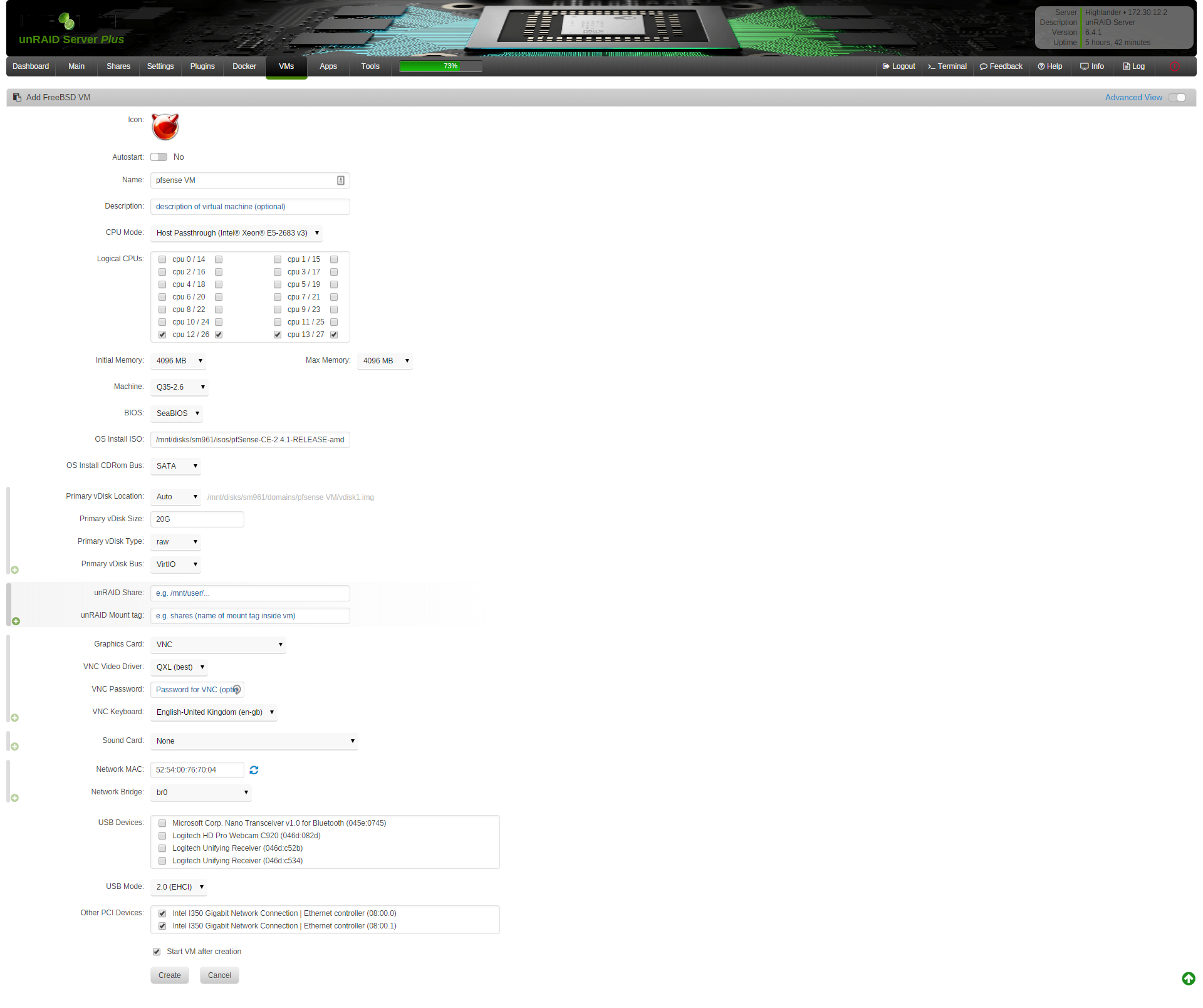

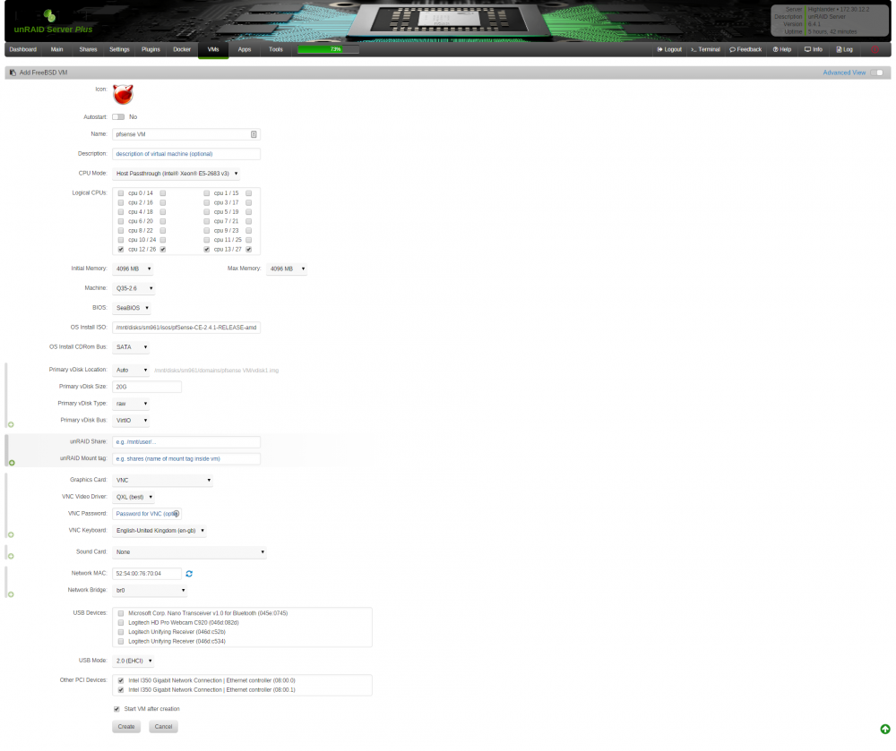

setting up a pfsense VM and passing through NICs is very easy.  I've just done a screenshot of the VM setup page for a new pfsense VM.  After start, you just setup pfsense as normal and treat it like a normal machine
5a87878aea22a_FireShotCapture57-Highlander_AddVM_-https___1d087a25aac48109ee9a15217a.thumb.png.096f263c83e83c428c73fc1ff09a81bf.png
Thanks
With the network bridge you are giving exclusive access to pfsense to one of the nic s?
How do you configure, and where the virtual switches? Is there an user interface or you have to go CLI?
