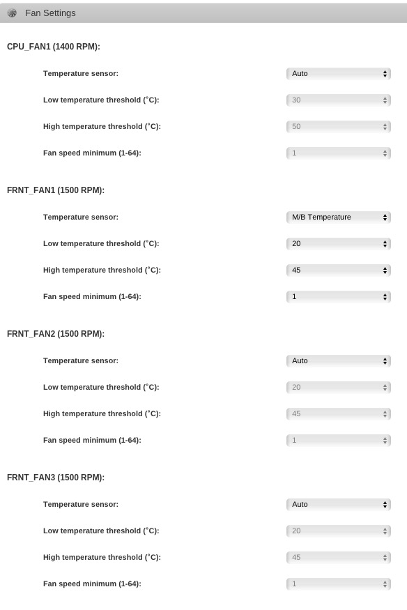

I still have occurrences when the temperature is high and the log is reporting 100% fan speed but in reality fans are running at 500rpm:
2016-08-19 06:02:06 Starting Fan Control
2016-08-19 06:02:08 FRNT_FAN1(100%):M/B Temperature(46°C)
MB is now at 66°C and the hottest disc at 45°
[EDIT]Maybe fixed, I decreased the thresholds in the motherboards smart fan settings. Seems to be important with the settings that I am using. Can anyone confirm that this is a correct understanding?
It will be linear between 20C - 45C. Below 20C fan will be off. 45C and above fan will be full speed. 32.5C would be 50%.

Hey,
I'm having this weird annoying issue with a Supermicro X10 xeon-d board, which had the SM "cycling" thing going at default... Switched a few things around in the IPMI settings, and the board will now boot with fans at a reasonable speed, which'll ramp up to full-on after a minute or so, so I'd suspect only once Unraid loads... I mean, it's not throwing errors or anything, it's mostly that it probably makes the box noiser than it could or should be...
(I've tried putting the upper thresholds to proper variants of the manufacturer's max speeds, didn't change a thing, and also tried adding the Dynamix temp/autofan plugins on top, no luck with that, can't detect the PWM controller or any other temp sensor than the CPU's coretemp)
Any clue as to what I'm doing wrong ?

I don't think you're doing anything wrong. That seems to be the way the Supermicro boards work. There's only a low, medium and high speed. If you look earlier in the thread there are some ipmi-raw commands. But if you set it to medium you might have overhating issues.
The ipmi settings and thresholds only affect warnings mainly. Changing them won't change how the fans operate. It‘s useful to eliminate any low rpm warnings.

I see this in the log:
2016-09-21 04:08:38 Starting Fan Control
2016-09-21 04:08:40 CPU_FAN1(48%):CPU Temperature(54°C), FRNT_FAN1(85%):HDD Temperature(47°C), FRNT_FAN2(85%):HDD Temperature(47°C)
2016-09-21 04:09:42 CPU_FAN1(22%):CPU Temperature(41°C), FRNT_FAN1(85%):HDD Temperature(47°C), FRNT_FAN2(85%):HDD Temperature(47°C)
2016-09-21 04:11:57 CPU_FAN1(36%):CPU Temperature(48°C), FRNT_FAN1(90%):HDD Temperature(48°C), FRNT_FAN2(90%):HDD Temperature(48°C)
2016-09-21 04:13:00 CPU_FAN1(20%):CPU Temperature(40°C), FRNT_FAN1(90%):HDD Temperature(48°C), FRNT_FAN2(90%):HDD Temperature(48°C)
2016-09-21 04:15:04 CPU_FAN1(16%):CPU Temperature(38°C), FRNT_FAN1(95%):HDD Temperature(49°C), FRNT_FAN2(95%):HDD Temperature(49°C)
2016-09-21 04:19:13 CPU_FAN1(18%):CPU Temperature(39°C), FRNT_FAN1(100%):HDD Temperature(50°C), FRNT_FAN2(100%):HDD Temperature(50°C)
but my fan speed is stuck at 1500
Fan.cfg
FANCONTROL="enable"
FANPOLL="1"
FANIP=""
IPMIBOARD=""
BOARD="ASRockRack"
FAN_CPU_FAN1="13"
TEMP_CPU_FAN1="21"
TEMPLO_CPU_FAN1="30"
TEMPHI_CPU_FAN1="80"

I'm only using Fan1 and 2, And they properly report the RPMs (I can hear them go up and down when I manually trigger it)
Edit 2: so while I can now at least manually choose the speed of the fans (which is nice to not have to boot into the bios) the auto setting doesn't seem to work for HDD, I set my low and high in the gui to 30 - 50, Yet the HDD are reading at 47C and my 5000rpm fans are only doing 1500. For now I manually set them to half speed, so my hard drives don't burn up, but I'm guessing there is something amiss with the auto, I know it uses ipmi as the fan controller, In the bios I have them all set to smart fan with the default temp > fanspeed setup. Is there something else I should do in the bios?
thanks!
Check that spot 5 & 6 correspond to front fan 1 & 2. I don't think they do since your fans are labeled 1 - 5. You'll need to change the names in the boards.json to match (just for ASRockRack) and make sure the order is right too. You can test with the raw command by running ipmi-sensors first (to get get fan names and rpms first) then change just one 64 to 32. You can skip the first since it's probably the cpu. Then run  ipmi-sensors to see which fan changed.
I'm working on a script that should automate this and write the boards.json with the correct values.
seemed like everything is properly named, the right headers correspond to the right fan labeling. After a reboot it seems the fan are spinning up and down like they should, I'm guessing it was a combination of setting the fans to auto smart in the bios and setting got it to work.

If you run the raw command it will stay till you reboot. If the fan control is run or running it will change it.
You still need to figure out the sequence of your fans and change the names in the boards.json to match. Run something like this
ipmi-sensors
ipmi-raw 00 3a 01 64 32 64 64 64 64 64 64
ipmi-sensors
ipmi-raw 00 3a 01 64 64 32 64 64 64 64 64
ipmi-sensors
ipmi-raw 00 3a 01 64 64 64 32 64 64 64 64
ipmi-sensors
... And so on. Taking note of the fan name and the spot whose rpm lowered in half. Then change the boards.json to something like this

When the ipmifan script runs it sets all other fans to 00 which is auto. With the default boards.json and the way your fans are named the command that is executed looks like this
ipmi-raw 00 3a 01 00 00 00 00 XX XX 00 00
where XX (a number between 1 and 64 based on temp and hi/low threshold) is the spot in the raw command that corresponds to FRNT_FAN1 and FRNT_FAN2 in the original boards.json. But even if you changed the boards.json like my previous example, the position of FRNT_FAN1 and FRNT_FAN2 may not correspond to the correct position in the raw command so
ipmi-raw 00 3a 01 00 XX XX 00 00 00 00 00
may not be the spots that control FRNT_FAN1 and FRNT_FAN2. That's why you need to figure out which spot controls which fan by running ipmi-sensors followed by a raw command with 32 only in one spot and 64 in the rest of the spots then ipmi-sensors again to see which fan changed rpms.
I hope that all makes sense.

You just need to edit the boards.json on your flash drive @ /boot/config/plugins/ipmi and restart the fan control service.
  "ASRockRack": {
    "raw": "00 3a 01",
    "auto":"00 00 00 00 00 00 00 00",
    "full":"64 64 64 64 64 64 64 64",
    "fans": {
      "CPU_FAN1": "00",
      "FRNT_FAN1": "00",
      "FRNT_FAN2": "00",
      "FRNT_FAN3": "00",
      "FRNT_FAN4": "00",
      "FRNT_FAN5": "00",
      "FRNT_FAN6": "00",
      "FRNT_FAN7": "00"
  "ASRock": {
    "raw":"00 3a 01",
    "fans": {
      "CPU_FAN1": "00",
      "FRNT_FAN1": "00",
      "FRNT_FAN2": "00",
      "FRNT_FAN3": "00",
      "FRNT_FAN4": "00",
      "FRNT_FAN5": "00",
      "FRNT_FAN6": "00",
      "FRNT_FAN7": "00"
The ipmifan script relies on the fans being properly named and in the correct order so it can create the raw command. Fan3 and fan4 don't exist in the default boards.json and fan1 and fan2 are in spots 5 and 6 so the script won't work.
I'm working on a solution to automate the creation of the boards.json
