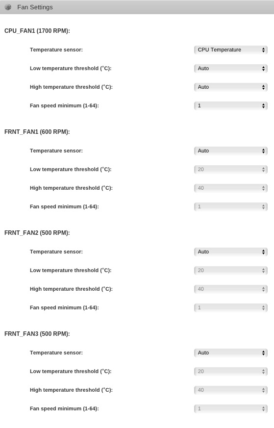

I have 3 PWM fans installed:
ipmi-sensors -t fan
ID | Name      | Type | Reading    | Units | Event
13 | CPU_FAN1  | Fan  | 1700.00    | RPM   | 'OK'
14 | FRNT_FAN1 | Fan  | 1100.00    | RPM   | 'OK'
15 | FRNT_FAN2 | Fan  | 1000.00    | RPM   | 'OK'
16 | FRNT_FAN3 | Fan  | 1000.00    | RPM   | 'OK'
17 | FRNT_FAN4 | Fan  | N/A        | RPM   | N/A
18 | FRNT_FAN5 | Fan  | N/A        | RPM   | N/A
In my understanding FRNT_FAN1-3 should all run on full speed if one of the discs or the MB is running hot? This is the case now. The MB is sitting at 53°C and one of the discs is at 45°C but FRNT_FAN1-3 are running at 500-600 RPM.
Fan Control Log:
2016-08-02 03:43:08 CPU_FAN1(100%):CPU Temperature(46°C), FRNT_FAN1(100%):HDD Temperature(46°C), FRNT_FAN2(100%):HDD Temperature(46°C), FRNT_FAN3(100%):HDD Temperature(46°C)
What should I do?

Basically if set to auto the fans will run based on cpu temp. I leave my cpu fan alone. The rest of the fans you have to configure and pick a sensor to run against. Either cpu, motherboard or hard drives. Then pick a linear range e.g. Low = 30, High = 40.  Also a fan speed minimum if you need to keep the fan above a certain rpm.
That said, looking at your fan names it might not work without some testing and a little modification to the boards.json.
Right now the fan matrix which maps the fan names to their place in the ipmi raw command is as follows.
ipmi-raw 00 3a 01 aa bb cc dd ee ff gg hh
      "CPU_FAN1": "aa",
      "CPU_FAN2": "bb",
      "REAR_FAN1": "cc",
      "REAR_FAN2": "dd",
      "FRNT_FAN1": "ee",
      "FRNT_FAN2": "ff",
      "FRNT_FAN3": "gg",
      "FRNT_FAN4": "hh"
This sets all fans to auto
ipmi-raw 00 3a 01 00 00 00 00 00 00 00 00
This sets all fans to full
ipmi-raw 00 3a 01 64 64 64 64 64 64 64 64
Run this for each fan location, changing the 00 to 64 e.g.
ipmi-sensors -t fan
ipmi-raw 00 3a 01 64 00 00 00 00 00 00 00
Check which fan changed to full. I would also use a value of 32 or lower to double check.
ipmi-sensors -t fan
Check next fan and so on.
ipmi-raw 00 3a 01 00 64 00 00 00 00 00 00
ipmi-sensors -t fan
Let me know how each fan name corresponds to its place in the raw command.
You can edit the boards.json in the ipmi plugin config folder on your flash drive to match your findings and the fan control script will work then.

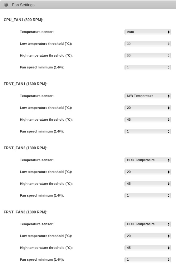

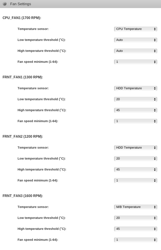

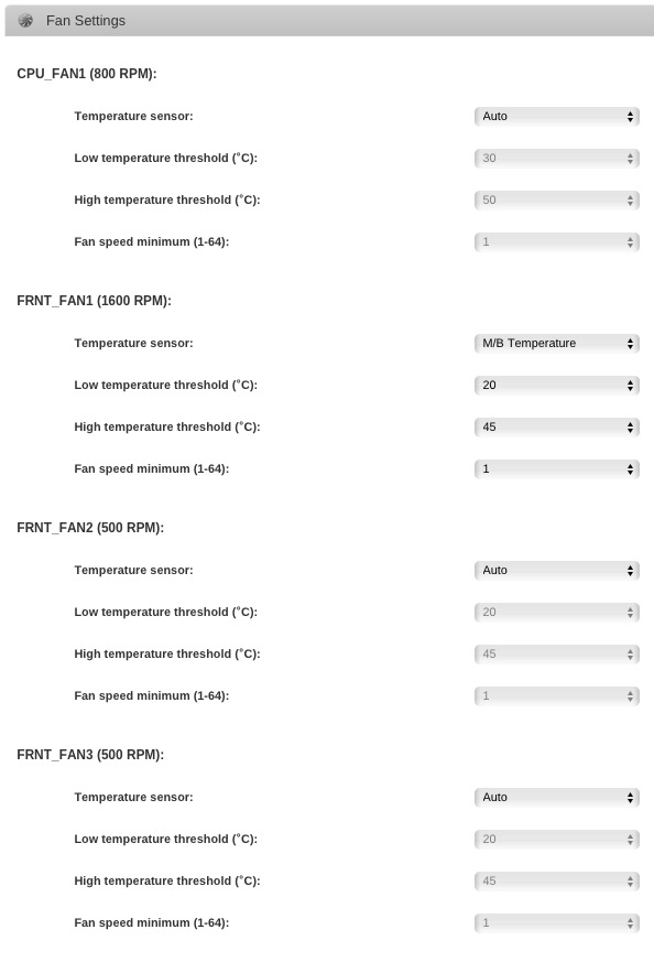

For the motherboard temp I would control a rear fan based on motherboard temp.
This command is putting CPU Fan to auto and the 3 FRNT_FANS to max:
ipmi-raw 00 3a 01 00 64 64 64 00 00 00 00
This is how I modified the boards.json:
  "ASRockRack": {
    "raw": "00 3a 01",
    "auto":"00 00 00 00 00 00 00 00",
    "full":"64 64 64 64 64 64 64 64",
    "fans": {
      "CPU_FAN1": "00",
      "FRNT_FAN1": "00",
      "FRNT_FAN2": "00",
      "FRNT_FAN3": "00",
      "FRNT_FAN4": "00",
      "FRNT_FAN5": "00",
      "FRNT_FAN6": "00",
      "FRNT_FAN7": "00"
  "ASRock": {
    "raw":"00 3a 01",
    "fans": {
      "CPU_FAN1": "00",
      "FRNT_FAN1": "00",
      "FRNT_FAN2": "00",
      "FRNT_FAN3": "00",
      "FRNT_FAN4": "00",
      "FRNT_FAN5": "00",
      "FRNT_FAN6": "00",
      "FRNT_FAN7": "00"
CPU is at 44°C, MB at 49°C and HDD max. at 36°C. See fan speed at the pic attached.
Does this look ok?
Does this look ok?
That looks fine. Except if you want to set CPU FAN to auto then change Temperature Sensor to Auto. I forgot to fix that in the last update but I need to remove the Auto option from Low and High Threshold.
Also I don't think you said but did you verify that second place in the raw command is fan1, third is fan2 etc. I need to work on a way to tell different fan configurations. And does ipmi-fru show ASRockRack?
I changed the CPU_Fan to AUTO but the log isn't showing that Fan anymore (see attached file Fan Settings):
2016-08-03 10:43:20 CPU_FAN1(85%):CPU Temperature(47°C), FRNT_FAN1(100%):M/B Temperature(48°C), FRNT_FAN2(64%):HDD Temperature(36°C), FRNT_FAN3(64%):HDD Temperature(36°C)
2016-08-03 10:45:30 fan control config file updated, reloading settings.
2016-08-03 10:45:33 FRNT_FAN1(100%):M/B Temperature(48°C), FRNT_FAN2(64%):HDD Temperature(36°C), FRNT_FAN3(64%):HDD Temperature(36°C)
2016-08-03 10:48:34 FRNT_FAN1(100%):M/B Temperature(48°C), FRNT_FAN2(56%):HDD Temperature(34°C), FRNT_FAN3(56%):HDD Temperature(34°C)

Should I move back CPU_FAN to let's say 30°C (low) and 50°C (high)?

There won't be anything in the log with auto. The fan is controlled by the motherboard's smart fan. That's what the 00 ipmi raw command does. Also when the script is stopped it sets all fans to 00 smart fan.  I just prefer to let the bios control the CPU fan. There is a small chance that if the script gets killed or the server crashed the CPU fan could be stuck at a low rpm or off (if the Low Threshold was set high enough) until the script gets restarted. But you should be fine using the 30-50 threshold and the CPU fan will be controlled by the script. The ipmi fru confirms you edited the right board.json array (ASRockRack).
That is an important hint and it happened to me already twice that the server didn't started properly, hence the script was not running and the fans were spinning at very low speed. Finally the disc's went up to 50°C  :o
Net, net your advise is to set CPU and the two side fans (the fans for the HDD's) to Auto and just the FRNT_FAN1 as shown in the picture attached because otherwise the MB will getting too hot when the disc's are all spun down (our conversation a few post above..).
