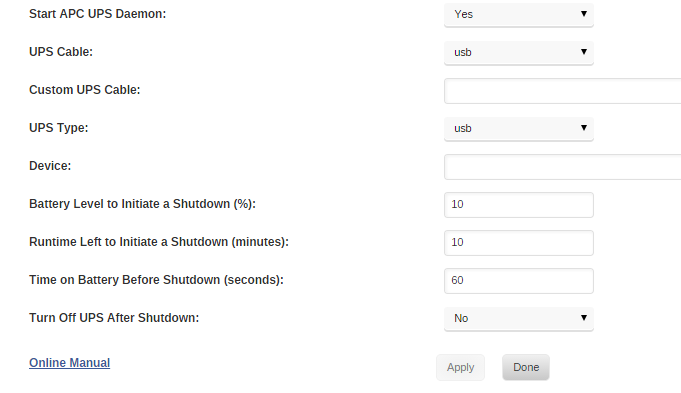

Setting up apcupsd does not require the services of a rocket scientist.  Below is the setup screen for the included apcupsd built into version 6.  (No need to install unMENU!)  There is a "help" button in the right right that will provide considerable detail what each setting does.  Most people can simply connect the UPS with an USB cable, 'Start' the service using the defaults, and everything will simply work.

i got the smc1000i model and am attempting to update the firmware. It has been sitting at 43 percent for quite some time now. Should I be worried? :(

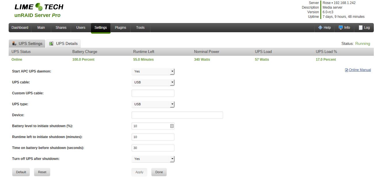

EDIT: all is well now, turns out it was a faulty usb port. Btw what does this mean? Seems different from the image above? I have also included my setting

though I dont understand some stuff from the picture I attached above, hope you can help :)
I also tried to simulate a power lost just now. While the NAS did shut down after a minute, the UPS seems to have not shutdown although I ticked yes to shudown the UPS too. Do I have to wait for a while for the UPS to shutdown?
Basically, the settings indicate that the software will start to initiate a shutdown of the server when (1) the battery reaches 10% of full charge, or (2) the battery has ten minutes of runtime left, or  (3) after the power has been off 60 seconds .
The ups_info.pgn picture is confusing to me.  It should be displaying numbers in all three of the positions.  The fact that it does indicates (to me) that the data coming from the UPS is not be properly interpreted by the software.  Not sure I would be worried about it at this point as long as the server shut down after you plugged the plug.  (Particularly, if you are considering upgrading to ver 6 anytime soon.)
By the way, neither of my UPS's will shutdown after the the server has shutdown.  I am not really sure what could really cause the UPS to shutdown in any case.  You sure don't want that shutdown to be triggered as so many seconds after apcupsd has started the server shutdown.  The UPS has no way of really knowing when that event has occurred UNLESS it is monitoring when the power drawn from it reaches some very low level.  If that is the case, what is the level .1w, 1w or 5w?

Im worried that the reason its not showing those data is because of a new microlink interface which apc uses for some of their new product which isnt linux friendly. I dont think this ups supports modbus like some other models so thats out too. But yeah it does work well(the auto shutdown of unraid feature)
about the auto shutdown of the ups, i just thought that the function would work as the option is there lol. I guess its not really critical as the power should come back on quite fast actually, and if all connected equipment are already turned off, it wont really lose much power too while connected to the battery.

Actually that's exactly how the UPS shuts itself down => part of the communications protocol is a "shut down in xx seconds" command that the monitoring software can send the UPS.    So that's exactly what it does.    Clearly you DO want to be sure "xx" is a long enough time for the actual shutdown to occur ... but that's reasonably predictable.    The APCUPSD package doesn't send that command until the array is already stopped, so there's not a lot of variability in how long it's going to then take.
Note that if a UPS is shutdown with this command, it will then auto-power-on when power is restored.  So if you have your server's BIOS power mode set to "always on", then it will automatically boot when the UPS comes back on.    This works very well and allows your servers to always be available except when they've been shut down for a power outage and the power has not yet been restored.

I believe the APC standard default "turn off delay" is 90 seconds ... and I don't think APCUPSD changes that.
So basically the UPS should turn off about 90 seconds after the system shuts down.  [Actually a bit less than that, since the "turn off" command is sent just before the final phase of the shutdown.

Yup, tested it again, and it did turn off after the NAS had turned off its just that it took about a minute or so.
And I also just enabled the restore power state after AC loss, and that seems to work well too!! Thought I'm gonna have to set up wake on land to wake it up in case of a blackout, but this is so much better. Thx again
