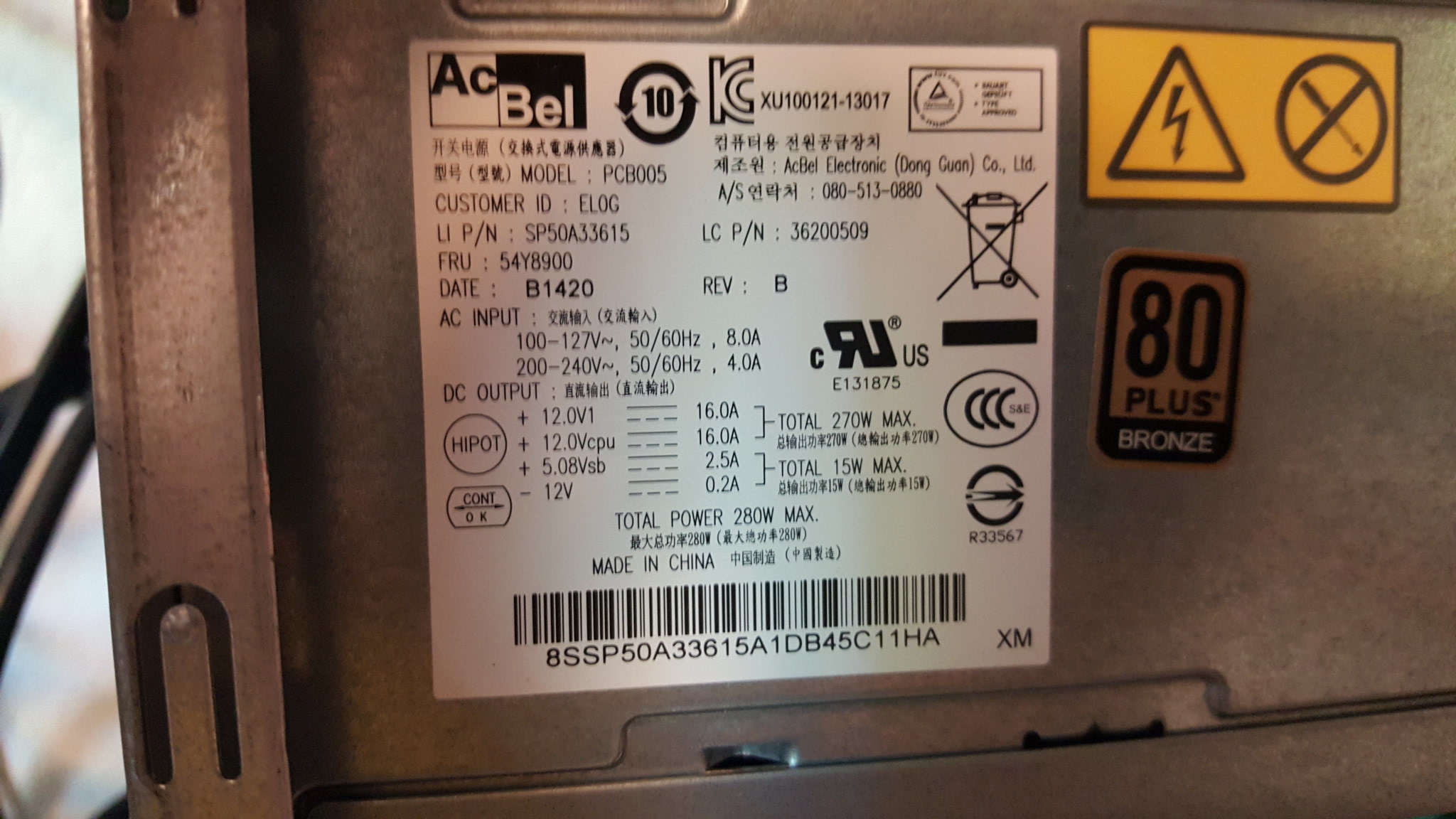

The number I get is 38.642556354 watts consumed in 40 hours and 22 minutes. Is this number meaningful? I guess I need to borrow a clamp on meter from work to compare. I was surprised by the very low number. Attached is a picture of the TS140's power supply label for your review.
Beside some 90mm case fans, the case holds only 3 HDD and 1 SDD.
Edited by Sabot
Since shutdown will spin up all drives, checking power during idle times isn't very useful.
Ok, I will get the clamp on meter and measure it during a shutdown. Fingers crossed that it's a small number so I can purchase the CP850PFCLCD with confidence with no buyers remorse.
