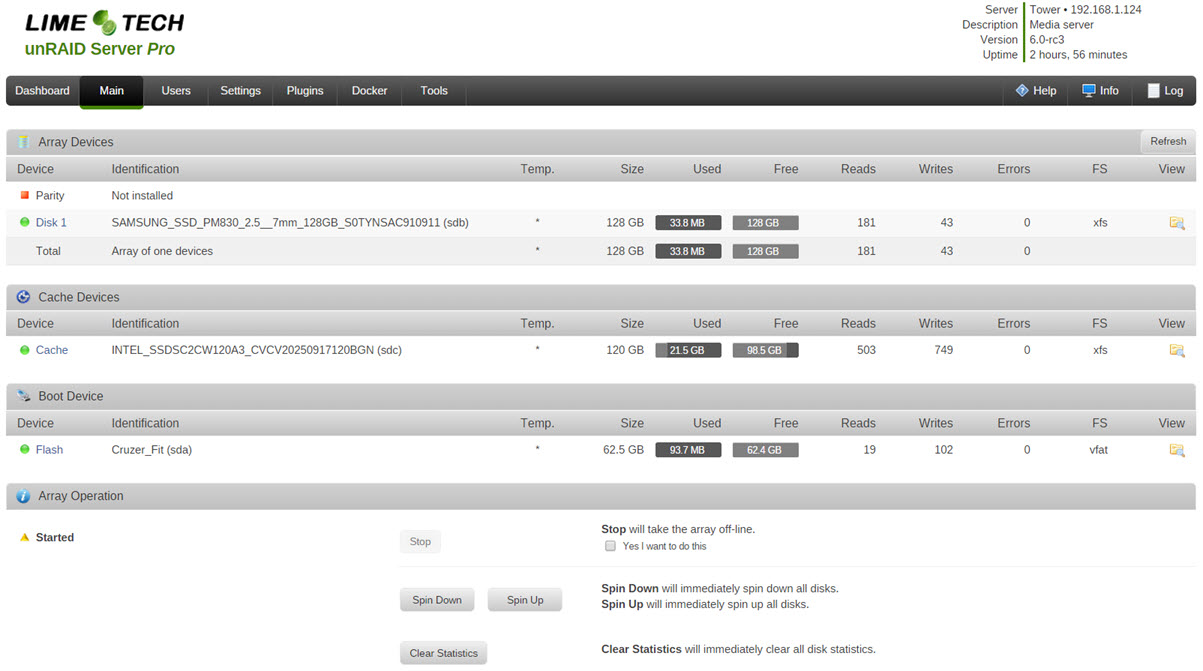

I wanted to use a cache drive to try out dockers, but is it even worth it trying to do this with just two drives? This is what my main screen looks like.
Don't know why you have a yellow triangle, but reconstruction can't be going on without a parity drive.
Not sure I understand what you are trying to do with the dockers. Are you trying to get them to use a network path to another computer for the host path? Have not heard of anyone trying that approach. Can you access that path from the unRAID command line?

I was just trying to setup the 'watchfolder', and the 'temp folder' etc. but it does not work. Once I saw my 'shares' button all gone, I figured the whole system was hosed and screwed up. I just wanted to check out the dockers, but since it is so new, I don't know if you can set everything up normally with one data, one cache. You see that little triangle trying to tell me something. I was just playing around with it, but when I couldn't create any shares on the data drives I was a little limited. I wish I can add another hard drive to that setup somehow, just to see it it all starts to react more normal.
You can turn on user shares still I believe from the "Settings -> Global Share Settings" page and then create them.
With only two drives (cache and array), you have no data protection, and since you're doing this on a laptop, your performance experience will vary greatly from a real system, but if you're just looking to get familiar with how things work with the software side of things, that's a fine way to do it.

Note that the only drives are an SSD data drive and an SSD cache.
?  Why do you assume they are SSD?
Edit:  never mind, I missed the screenshot of the GUI.
Yes, the system is very fast and reacts very quickly. It does have a Gb NIC as does my whole network. True managed Gb ports on my router too.
