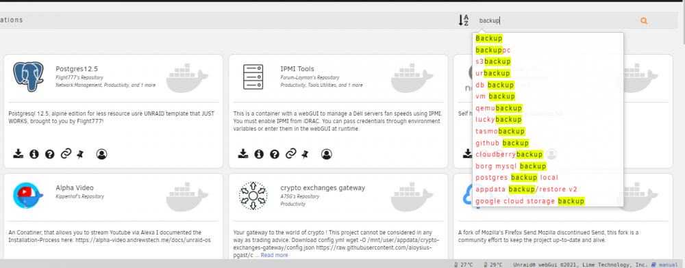

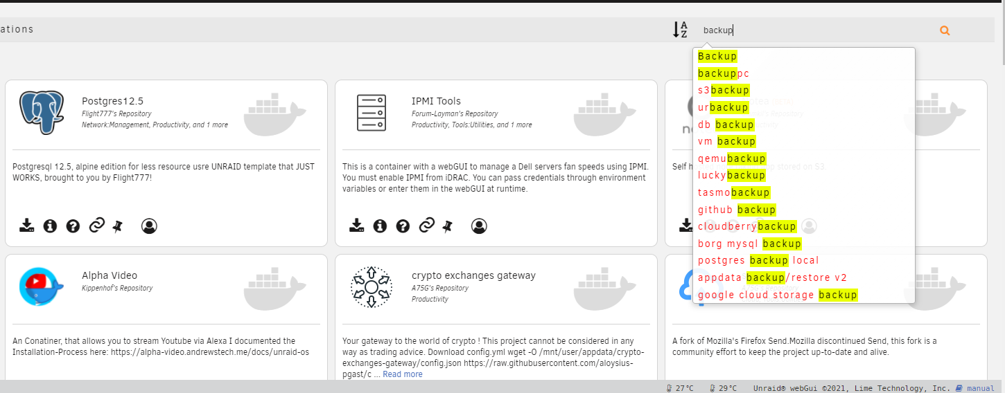

11 minutes ago, kizer said:
I just remoted into my machine using Chrome Version 90.0.4430.85 (Official Build) (64-bit) and it worked just fine.  Did 4 back to back searches. The below is the last one I searched for.
Is there a possibility your running some adware or something that might be blocking the popup results?
Hard to explain this one, I just did some searches again it worked fine, then I refreshed the page stopped working again, go figure :)
We need more people here to confirm .
