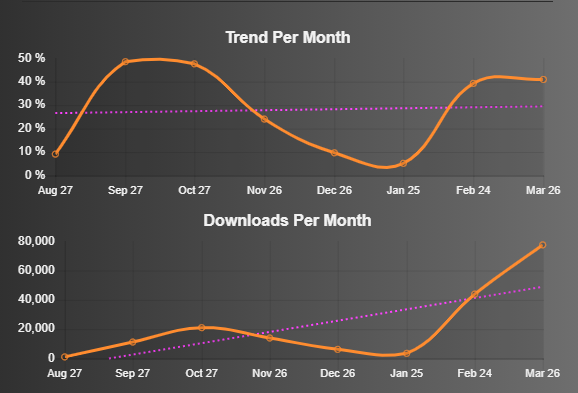

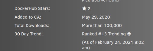

I'm somewhat confused about why FoxxMD's pinry application is seemingly 'stuck' to the Trending and Top New Installs for at least the past few weeks if not longer. I don't mean to disparage their hard work on their project, but I'm having a hard time believing that a selfhosted version of pinterest is setting the world on fire, especially given that the Unraid support thread has a whopping 10 posts, none in the last six months.
So that's why squid is driving around in a fancy new sports car 😆
I'm guessing because CA pulls dockerhub stats (not just unraid) and FoxxMD is using the official image.
yup.  And the more downloads a given container gets, the harder it becomes for it to stay in Top New or Trending.  You can already see the trend decreasing even though the number of downloads per month has increased.
