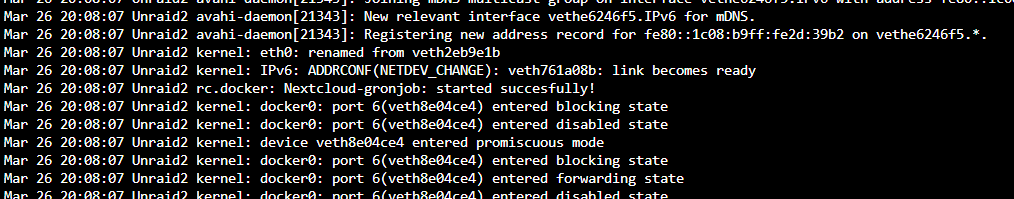

When you open the syslog window do you have stuff scrolling by endlessly or is it quiet?
Interesting, it's a ton of nginx error messages:
Mar 26 03:17:13 LIBRARY nginx: 2023/03/26 03:17:13 [error] 31026#31026: nchan: Out of shared memory while allocating message of size 503. Increase nchan_max_reserved_memory.
Mar 26 03:17:13 LIBRARY nginx: 2023/03/26 03:17:13 [error] 31026#31026: *33427723 nchan: error publishing message (HTTP status code 500), client: unix:, server: , request: "POST /pub/devices?buffer_length=1 HTTP/1.1", host: "localhost"
Mar 26 03:17:13 LIBRARY nginx: 2023/03/26 03:17:13 [error] 31026#31026: MEMSTORE:00: can't create shared message for channel /devices
I added that docker a few days/weeks ago, but haven't bothered to configure it since. I just removed it.
These would be unraid's GUI running out of memory.
A container that's installed but improperly configured can be endlessly starting/stopping every few seconds filling the logs.
So reboot the system to purge the log. Then because nginx has been removed, the problem shouldn't come back?
As mentioned nginx referred to the nginx that is part of unraid and providing the webgui, not one in a container.
Gonna have to maybe watch it for a while, check syslog for repeating messages of a container starting/stopping al the time, which would look a bit like this
