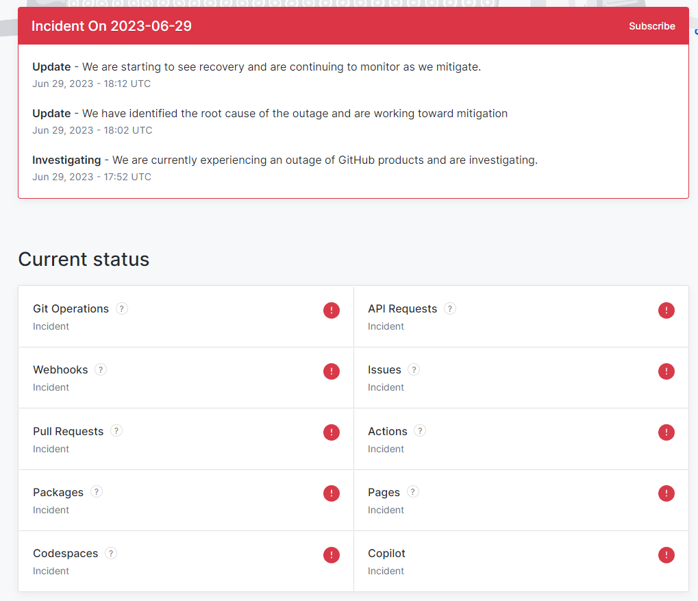

Its either GitHub (they were having some problems yesterday) or your server is unable to reach github itself.  Not much difference except that plugin installs may fail and some icons for various apps may be missing.
Thank you....
