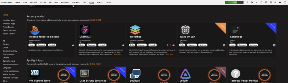

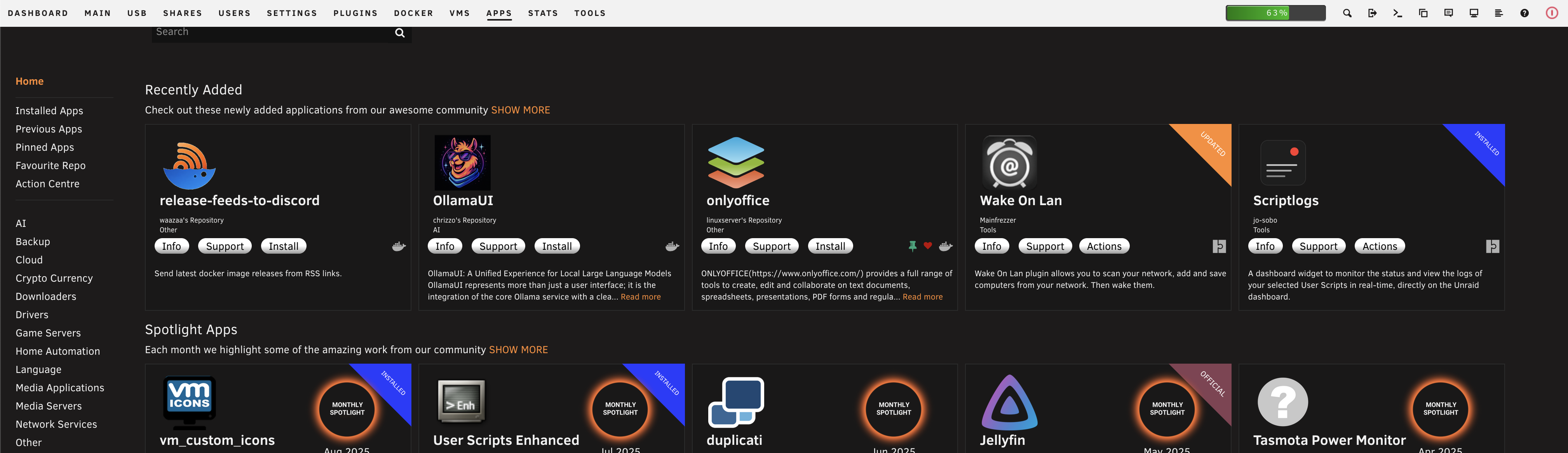

Is the search box being cutoff just me? I tried clearing cache. Been this way for the last several CA updates on UR 7.1.4
This was fixed on the update the other day. Slipped through because it didn't happen unless the font size was set to something other than "normal" on 7.1 and earlier and didn't manifest itself at all on 7.2
