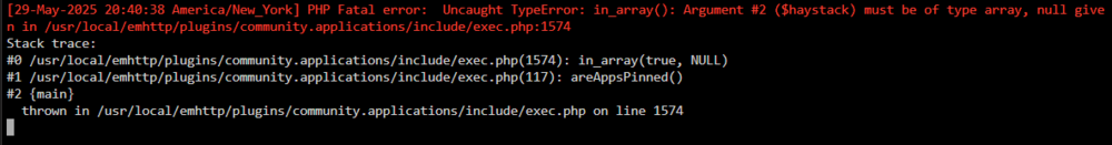

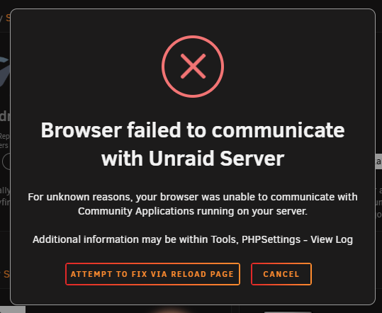

Receiving this error after updating my CA plugin. Anybody seen this? I performed a complete removal and reinstall of the plugin but it just did the same thing.

After having updated to CA 2025.05.29 - I'm receiving the exact same error.
Someone posted this on Discord:
[29-May-2025 19:26:32 America/Chicago] PHP Fatal error: Uncaught TypeError: in_array(): Argument #2 ($haystack) must be of type array, null given in /usr/local/emhttp/plugins/community.applications/include/exec.php:1574
Stack trace:
#0 /usr/local/emhttp/plugins/community.applications/include/exec.php(1574): in_array(true, NULL)
#1 /usr/local/emhttp/plugins/community.applications/include/exec.php(117): areAppsPinned()
#2 {main}
thrown in /usr/local/emhttp/plugins/community.applications/include/exec.php on line 1574

Same error here, glad it's not just me, but sorry it's just not me. I was in the middle of installing several applications when I noticed the CA update. I installed it, then CA stopped working w/ the same error message as above. I can't find the deprecated plugin to reinstall the old, functional version.
I attached my error log.
29-May-2025 Error Log.txt
Edited by SoleInvictus
Also getting the error.
Yep; just got the same, down to the stack trace in PHP Logs.
Same error and same logs as all the rest.
I am also receiving "Browser failed to communicate with Unraid Server" after updating community apps. Currently on Unraid 7.0.1
for now you can remove plugin, install old version from the install plugin page on the plugins page using this url:
https://raw.githubusercontent.com/unraid/community.applications/4e0da5c4c810188735683fab63ef1a676dac30a2/plugins/community.applications.plg
once on the old version go to apps page and click any app on the page and click pin app, then you can update to the newest version if you'd like and it'll work
credit goes to @EDACerton for the temporary fix until squid can push an update to resolve
Edited by jcofer555
For until Squid can issue a fix, here's a workaround:
Remove CA from the plugins page, then go to "Install Plugin" on the same page and use this:
That will install the previous version of CA. Once you've done that, you can either:
  1. Stay on that version until a new update is released, or
  2. Pin an application (click on Info for an app, then Pin App). Once you have an app pinned, you should be able to update safely.

Thank you for the 30 second fix!
10 minutes ago, Squid said:
Fixed. Sorry guys
Confirmed that 2025.05.29a fixes it. Thanks so much for the quick action, Squid.
