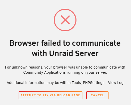

Hey all,
Wonder if someone can help. I'm unsure where this error lies, but I'm getting constant "Browser failed to communicate with Unraid Server" faults, reloading the page. Checking the diagnostics, I can see segment faults within the PHP when it's doing requests. I contacted unraid support, who mentioned doing full diagnostics of the hardware, which all reported as fine. I've even tried TruNAS just for the sake of testing and I had 0 errors with that. They said there isn't much more they can recommend and suggested posting here because it's a CA store issue. Reloading the page with the error makes the error reappear. Maybe after the 6th one it will go away for around 20 seconds. Basically, the CA store is unusable for me as I have to reload it each time I search for anything.
PHPSettins logs shows no errors.
homelab9-diagnostics-20250310-1156.zip

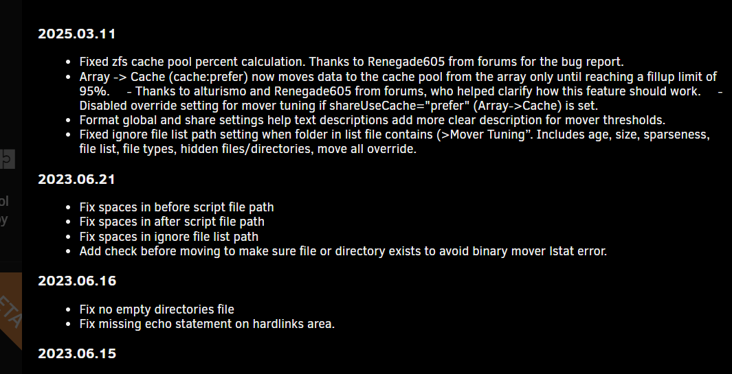

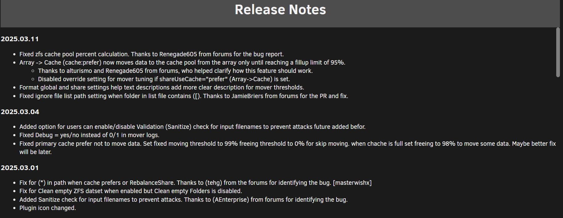

For mover tuning plugin today/last version in CA :
When in plugin page :
So its cutting some text ?
using chrome browser.
The issue was because '[' character

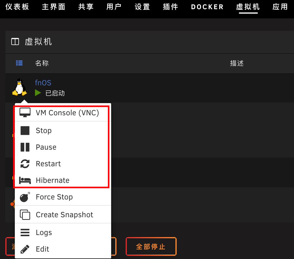

Addtional, in docker and vm page, language translation is not correct(i use simplified chinese). This has something to do with the search failure
