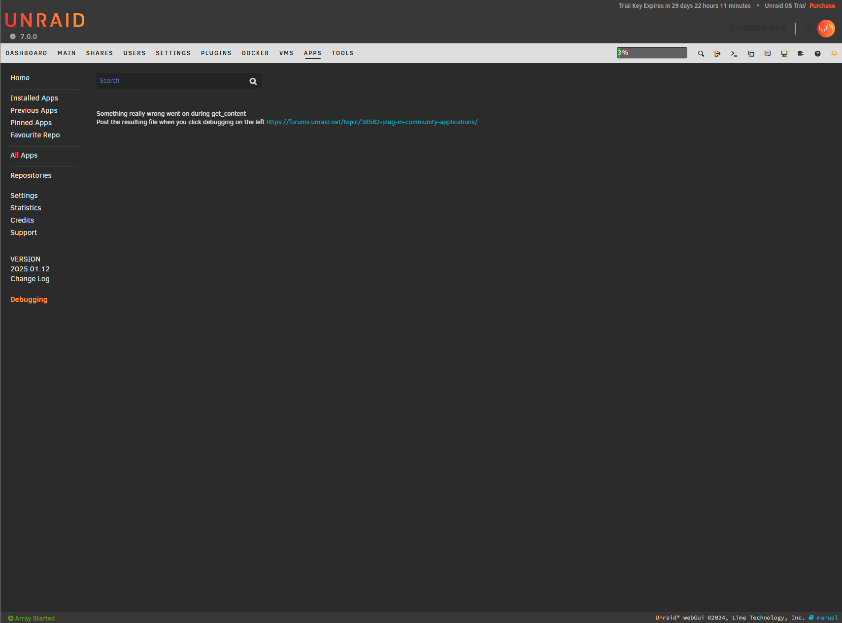

I'm new to unRAID. This is a new installed system with a free trial.
I'm trying to get some apps and play with the system a little bit before deciding to buy. But I'm getting this error each time I entring the apps tab.
I've attached the ca_log.txt
Unraid version: 7.0.0

Unfortunately (Probably Nord's fault lol) I can't seem to download your log.
Can you try disabling all extensions and see if there's any change?

I found out it related to the browser (Chrome) somehow, when I trying to access the apps from another browser there is no problem.
I tried to clear cache, cookies and site data - didn't help. Even delete and install Chrome didn't solve it. Any ideas?
5 hours ago, Osher said:
Any ideas?
See the last few posts, are you using NordVPN by any chance?
