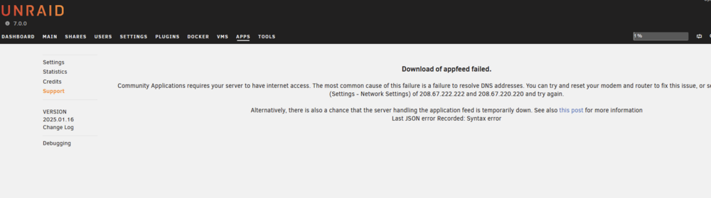

This still doesn't work properly. I'm on 7.0.0 and I get the below screenshot constantly when I visit the apps page. I'm on the latest version and I do not have the tailscale plugin installed.

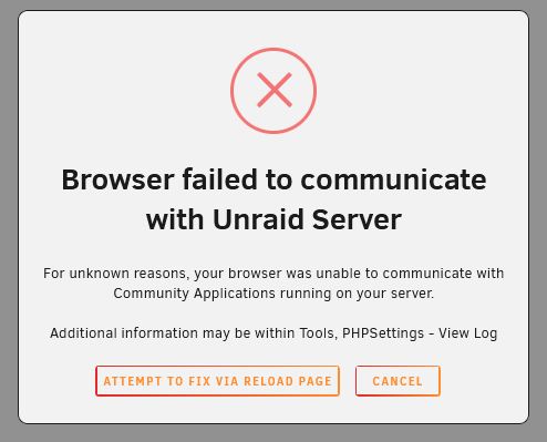

What problem exactly?  Popup saying failed to communicate?  Or download failure?
Failure to communicate.
I just repeated the experiment.  VPN from US to EU == no communication.  Direct connection in the US == works as expected.
Interesting.  I'm going to be looking at some further logging relating to this in the next few days, but in the meantime can you go to plugins, install plugins and paste this URL in
https://github.com/unraid/community.applications/blob/0ae07b41998cc1d12ebe14c4f51156885dfb2e9d/plugins/community.applications.plg
and then see if it works.  If it fails, there should be a more descriptive message appear - post a screenshot.  If it works then I'll put on my thinking cap
After you do that, then you can hit the update on the banner.  (What you're doing here is going back a couple of versions of CA before a specific change was made)

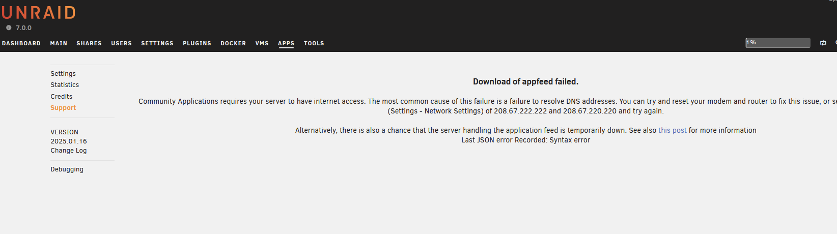

Hi everyone
after upgrading to OS 7.0.1 Community application stopped working with error
Download of appfeed failed.
Community Applications requires your server to have internet access. The most common cause of this failure is a failure to resolve DNS addresses. You can try and reset your modem and router to fix this issue, or set static DNS addresses (Settings - Network Settings) of 208.67.222.222 and 208.67.220.220 and try again.
Alternatively, there is also a chance that the server handling the application feed is temporarily down. See also this post for more information
Last JSON error Recorded: Syntax error
last post I found was back in 2023 and it seems it was from Unraid side and things back to normal after a while
My DNS works fine and tried a couple of different ones they all failed with same error.
anyone having same issue?
Thanks
