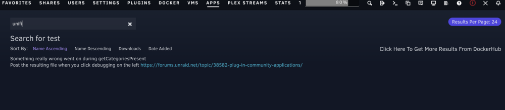

Suddenly i can nolonger search for apps in the CA store...
No VPN used..

Also something I noticed.. If you try to search for something in the CA store, then select a Sort By option it starts to work for me.. I'm able to then have results returned.

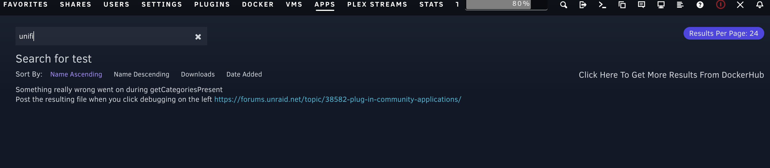

I get this when I search for an app now after "upgrading" to unraid 7.0
Hi @FreakyBigFoot, I'm having the same issue, but your workaround seems to work for me. thank you
@zer0ish Try selecting a Sort By option and you'll see results :)
Edited by FreakyBigFoot
Ok this works, but this is still a bug as this isn't the intended behavior of the search function.
I should just type what I'm looking for and it does the search.

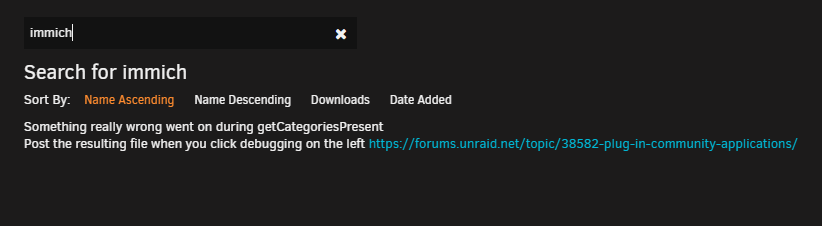

I came to the forums because I ran into the same thing and I found this temporarily solved it for me. Thought I would share.
Hello Everyone, I am new to unraid and I was trying to install the intel gpu top plugin and I was unable to search for the plugin, tried rebooting the system and tried to downlaod an app to see if that works, I still got the same error. Can someone kindly aid me in resolving this issue. I tried uninstalling the community applications plugin and reinstalling it to see if that works, still the same issue. It worked perfectly fine last time I downloaded plugins and apps, around 2 days ago. I'm currently in version 7 cr 2. Thought this is an issue with the beta and installed the version 7, still the same issue.image.png.74d57081481f900b7c3058df19c4ffbe.png
