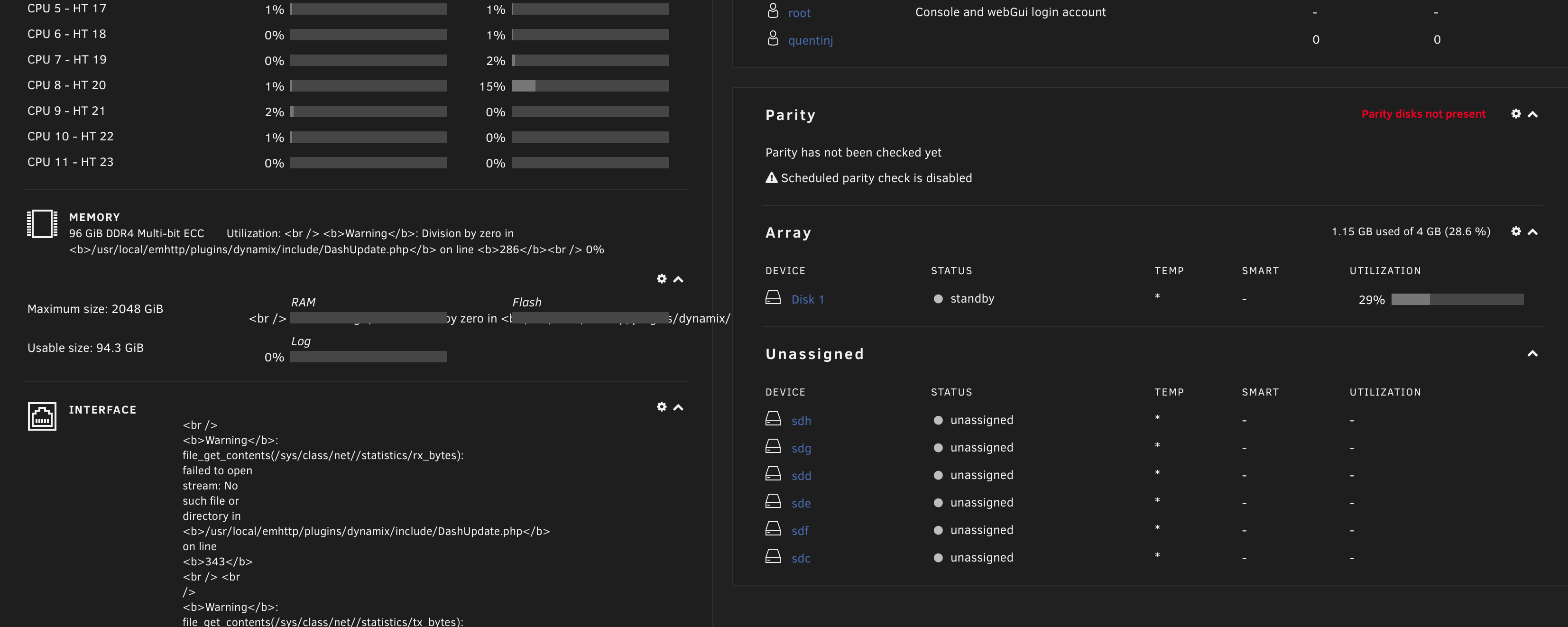

Upgrade to beta 4 has completely borked my system.  That's my current technical assessment anyway.  It took me ages to figure that out too.
All sorts of errors about missing shared libraries, and also doing odd things like removing the docker and virtual machine menus from the Unraid GUI, also noticed it's telling me docker can't start because VT-d is missing - well it's a dual Xeon I don't think so.
So far I don't recommend any of these betas and regret using them at all.
I've tried to downgrade to beta 3 using the above method which is saying ZFS modules are not loaded so something is not right.
This is all happening at a time when I have no time.  But I need it to run.  If I had the time I would reformat and downgrade to stable ZFS.
ZFS beta HIGHLY NOT RECOMMENDED on UNRAID is my current opinion.
The funny thing is that ZFS itself is running in the background - even when the menus are missing docker and vm's are running too (or were at least).  It's also causing other issues like randomly not being able to boot from USB stick.
My guess is that like the other assumption it's more of an issue to do with the implementation of ZFS as per how it's attached to unraid.  But I don't know.
Even the nerd pack is throwing up errors with this installed.  It's possible it's something else I haven't thought of, but when I disable ZFS everything else starts to run normally again.
Painful!
@steini84 Are you sure something in the new build of ZFS beta4 isn't overwriting parts of the system it shouldn't?  I've even got it complaining I've got less that 2G of memory in the GUI, yet in the console it's saying I have 96.  Check out my main screen. I've done a memory test too just in case.  Check out how docker and VM tabs are missing, but actually they're running.  Weird scripting / coding language showing up in the GUI.

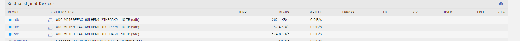

question, how do you guys monitor the disk smart when using ZFS?
unassgined devices plugin is not monitoring disks that are not mounted right?

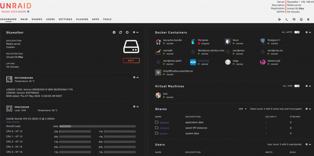

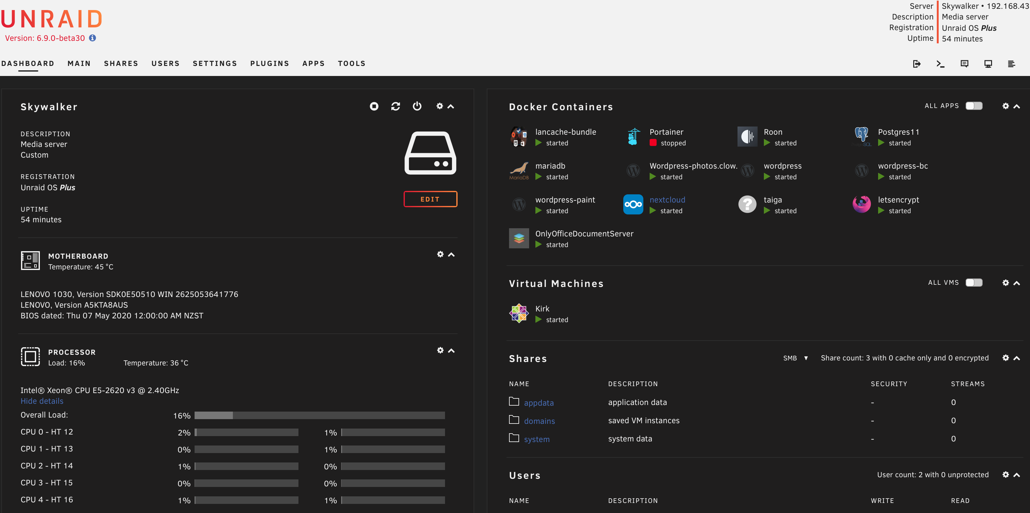

I use check_mk for overall monitoring of my servers and everything that has a network. It seems that the unassigned drives are being monitored by unraid :b9c441f6e8c8b8da80c32544c880fce7.jpg&key=2ef2c864ae165ac407b212a8775ce26d642a357267c109c8054e4d0424645afe
interesting not on mine :S  (those disks are a zfs pool)
shall I need to do something else?
interesting not on mine [emoji37]  (those disks are a zfs pool)
Check the Dashboard tab, you are in Main
oh.. sorry what a newbie I am...
yes says smart ok, so I supose if in the future some issues are detected I will be notified as any disk in the array, right¿?
