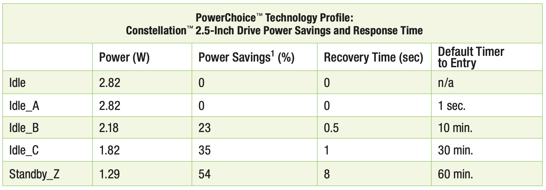

I get the feeling this drive power down isn't as much of an issue now.  75% less consumption with the newer drives.
901924862_ScreenShot2020-12-20at9_50_53AM.thumb.png.a328a64cf70e3af72d337e0864a4b442.png
