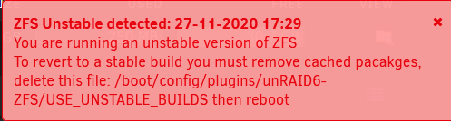

Is it possible to get rid of / waiver this error/warning?
I know that I'm using an unstable version, and everytime after a reboot this shows up and shocks me. 🙃
Yeah you can just remove lines 444-446 in the plugin. For example using nano
nano -c /boot/config/plugins/unRAID6-ZFS.plg

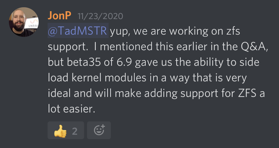

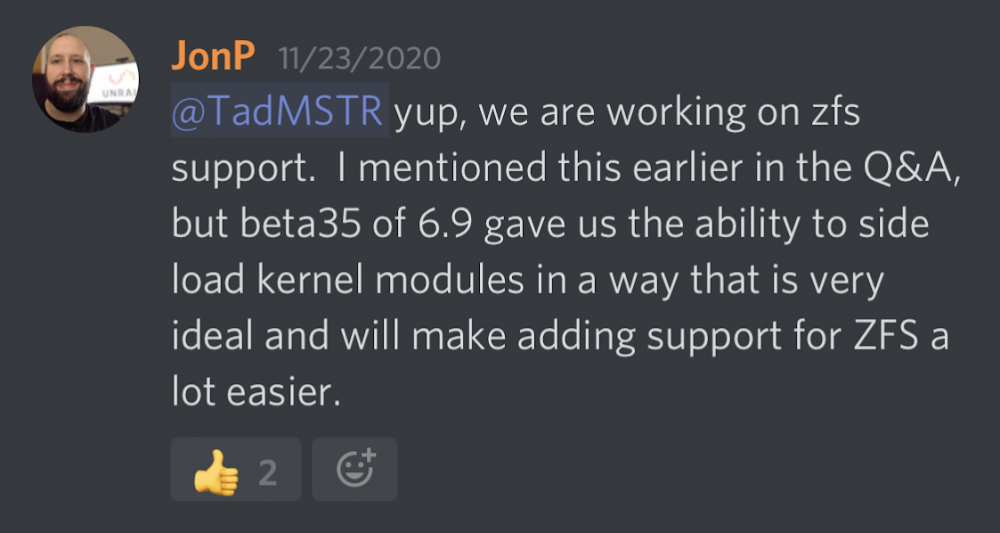

Does this mean we can upgrade to 6.9 rc1 directly?
It should be as easy as removing the ZFS plugin and upgrading to beta35 and do the side load right?
Does anyone know if they are also working on GUI/array support with ZFS?
Would love to contribute to the development but not a clue where. Unraid with zfs array support would solve all my needs!
