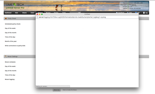

Hi...
Current version 6.1.3 - (Moved to it yesterday...so far so great.)
Option at the top right - LOG will open a window but the window never fills in.  It just is "Waiting for Server"
OS - Mac - Chrome Browser.
I can get to the System Log under TOOLS.
Any thoughts?
Thanks
(Side Note...Attachment size limited to 192K? Ouch.)

Any antivirus or adblocker software running? If so then exclude the GUI pages.
Other windows open just fine.  So does this one, it just never fills anything into the box.
It is trying to open...
http: //server/logging.htm?title=Log%20Information&cmd=/webGui/scripts/tail_log&arg1=syslog

Done both.  Even tried another browser just for kicks.  The open window just waits for the server to send data that is never sent.  I can open other windows and the info shows in the windows.  I can also go to the tools area and see the log without issue.

Interesting enough that if I open a browser and goto....
...nothing opens in the page.
If I just load...
http://server/logging.htm
...I get a DONE button.
It is NOT able to open a TAIL it seems.  This is very pondering it does not work.
