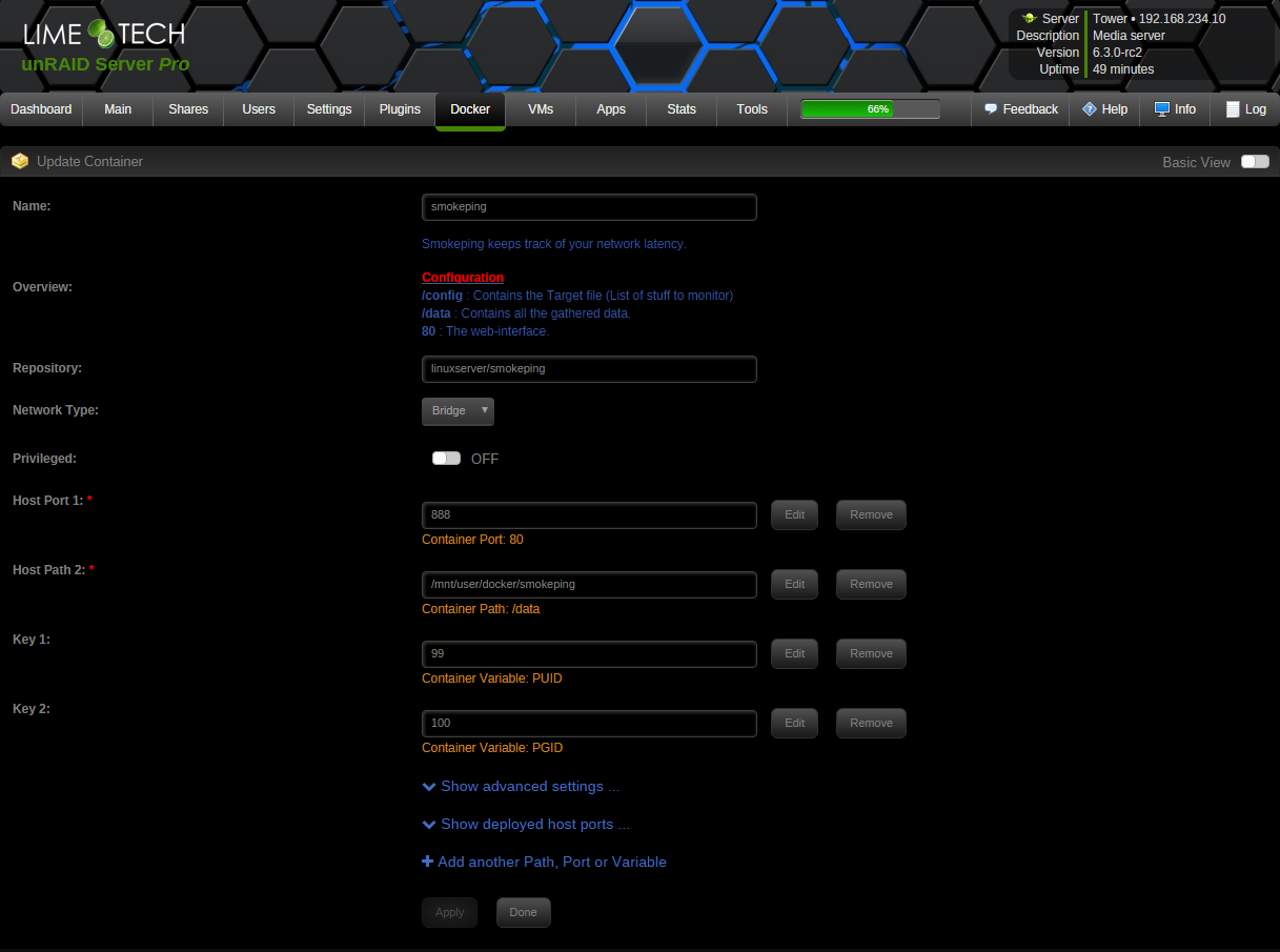

Please post screenshot of your template and post the log from the docker.

Template shot attached..

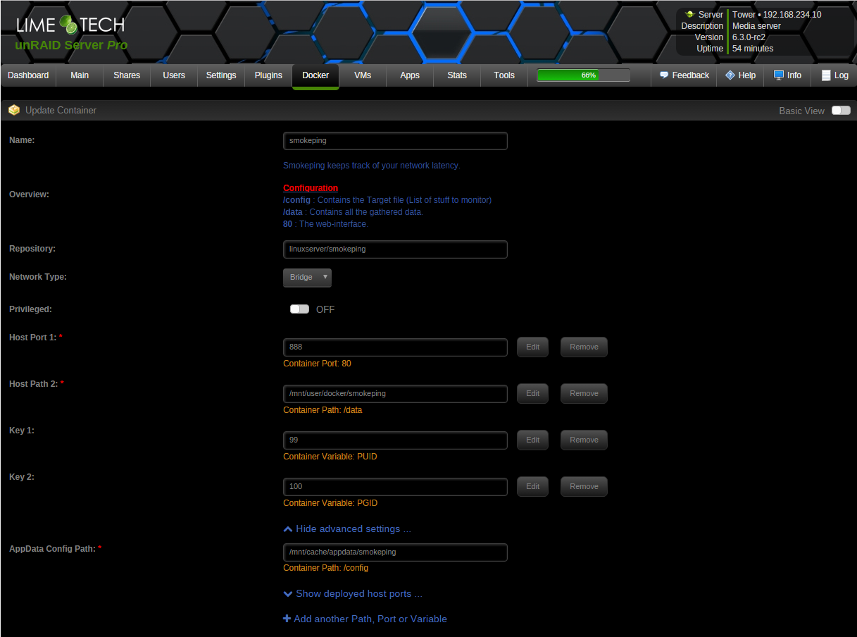

Please post a screenshot of the advanced settings also. I suspect you map the same host folder for both data and config.
Then you'd be wrong ;)
