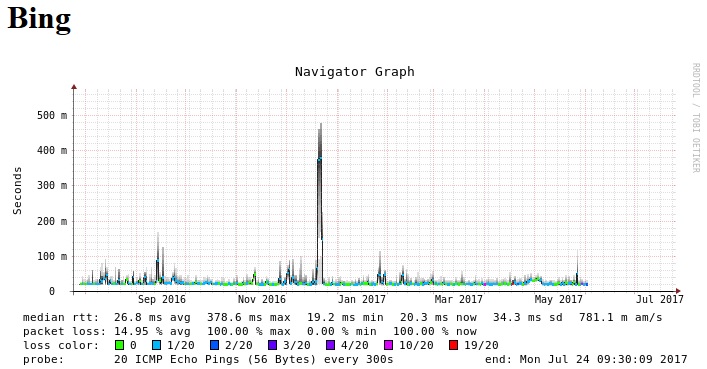

Now I finally have some ammunition to take on my ISP regarding packet loss.

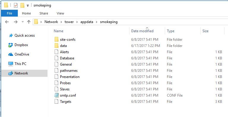

I dusted this off today and can't get connected to the webserver any longer.  When I attach to the docker it appears that everything is running. the log file appears clean.
I just can get to:
http://192.168.1.107:8080/cgi-bin/smokeping.cgi
I get a message
The requested URL /cgi-bin/smokeping.cgi was not found on this server.
If I just go http://192.168.1.107:8080 I get a message "it works"
Makes me think I've got something wrong in a config file somewhere.
Ideas?
thanks
david

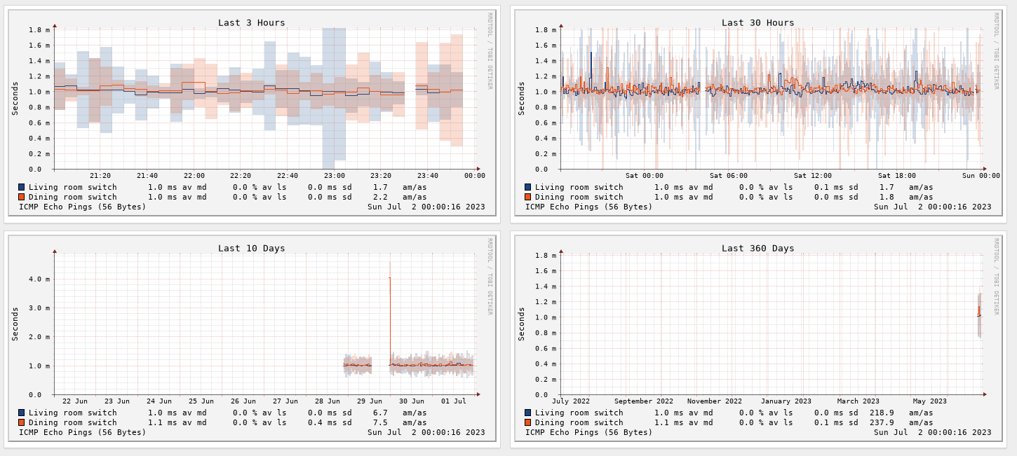

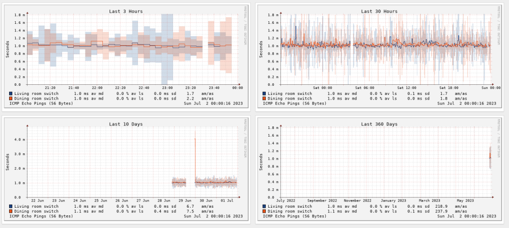

That is done in your Probes file.  The step and count control the frequency and quantity.  Be aware when you change the step or count you will have to delete the .rrd files associated with the probes you change as the database is governed by the time/count.
I am having a problem with my .rrd data going away, sometimes after a reboot.  I suspect that some part of the container is not pointed to the right place as I do not see a data directory in the smokeping folder on my cache drive.
My server is up 24/7 and all of my graphs should go back months.
