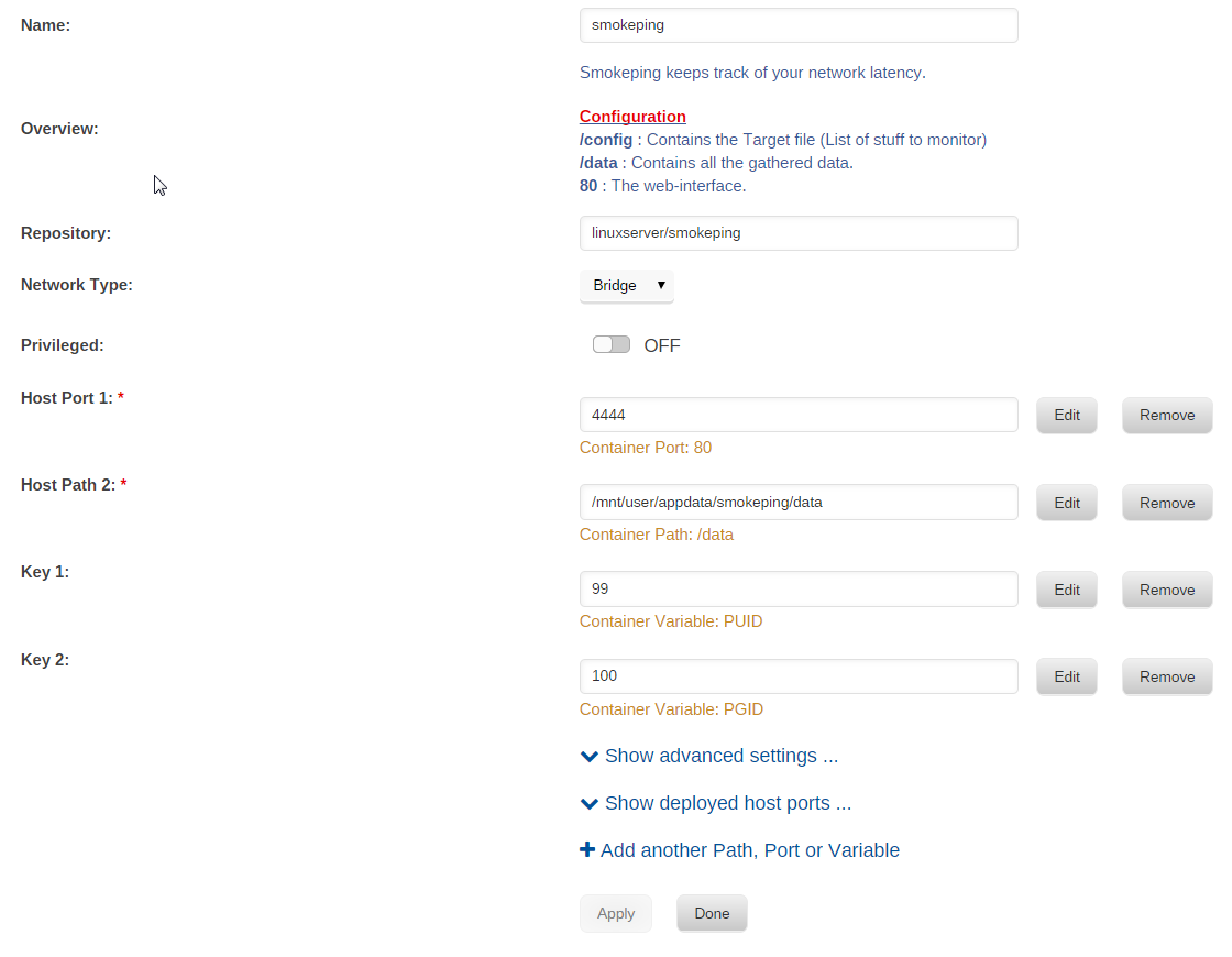

But here's the GUI config.

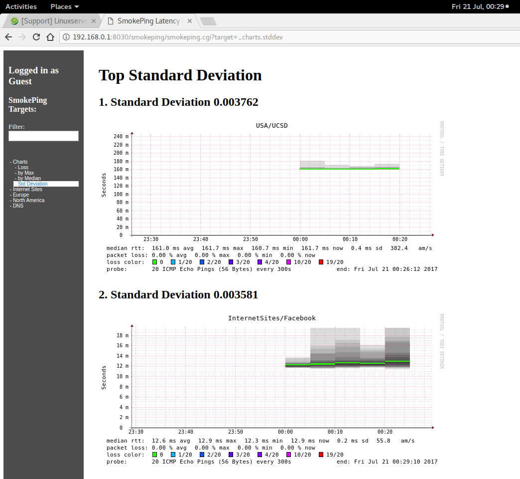

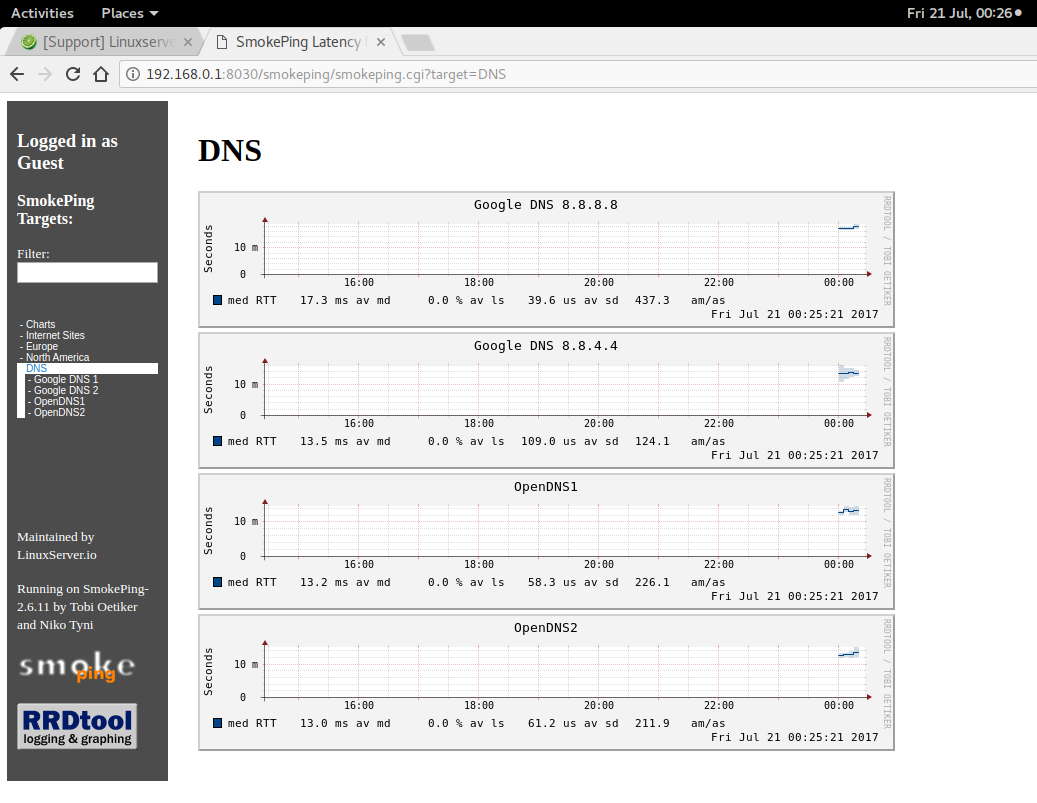

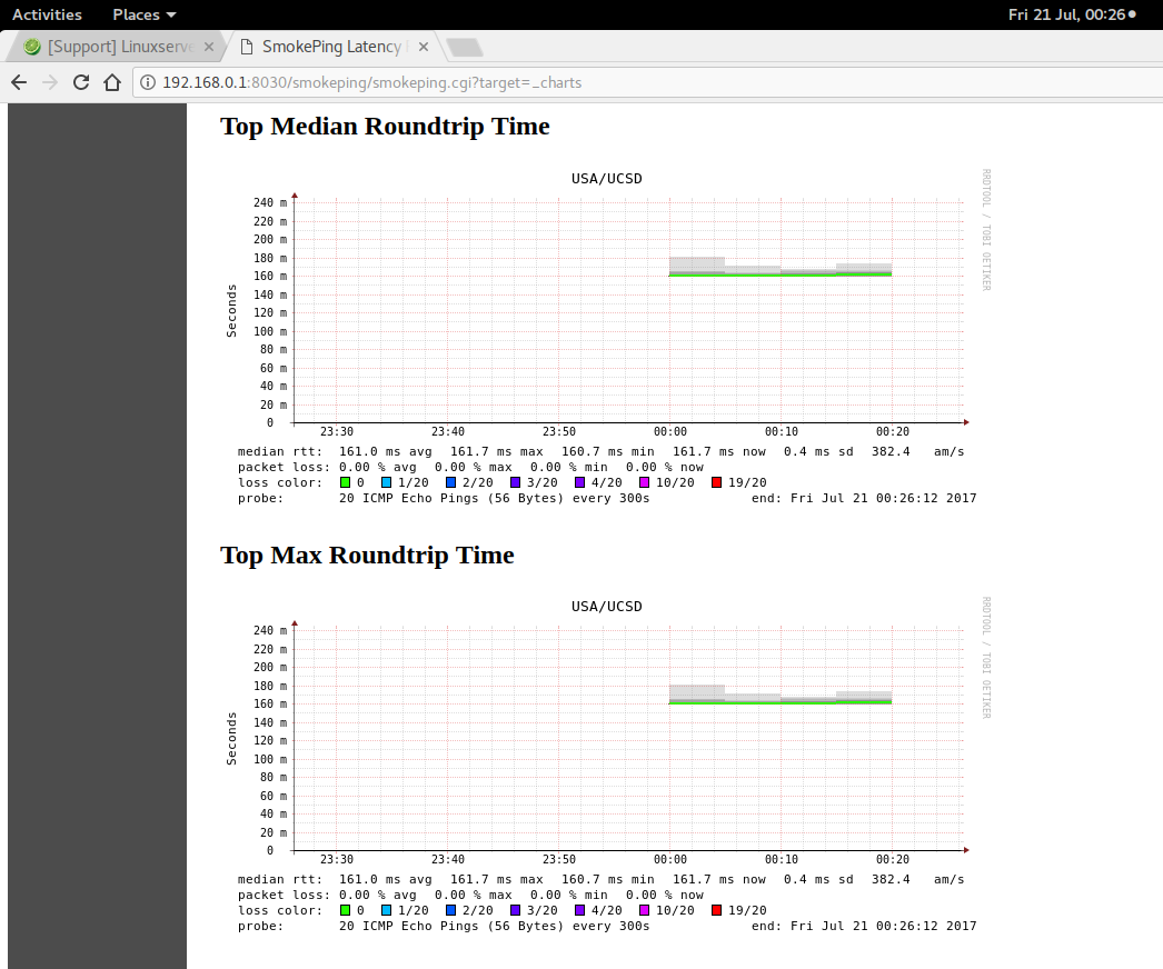

And finally here's some screenshots of my smokeping install from tonight.
Undoubtedly there are several of you with issues, I'm guessing there's something common amongst you all, but I don't know what.
