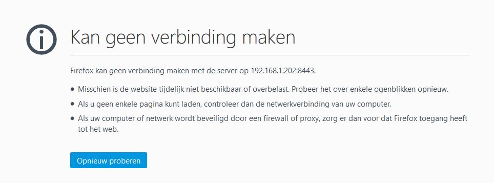

can some one help me
the web ui won't open
Would be nice to have the error message in understandable language....
But did you use https:// in front?
i use dashboard - unifi - webUI  (https://192.168.1.202:8443/)
the error is can't connect to

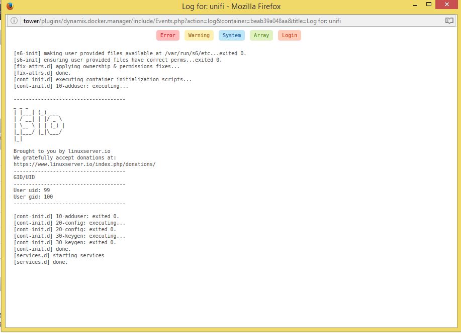

logs from unraid says
Nov 22 10:22:31 Tower shfs/user: err: shfs_write: write: (22) Invalid argument

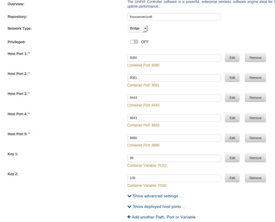

are there more settings i have to fill in
or settings i have not fill in correct?

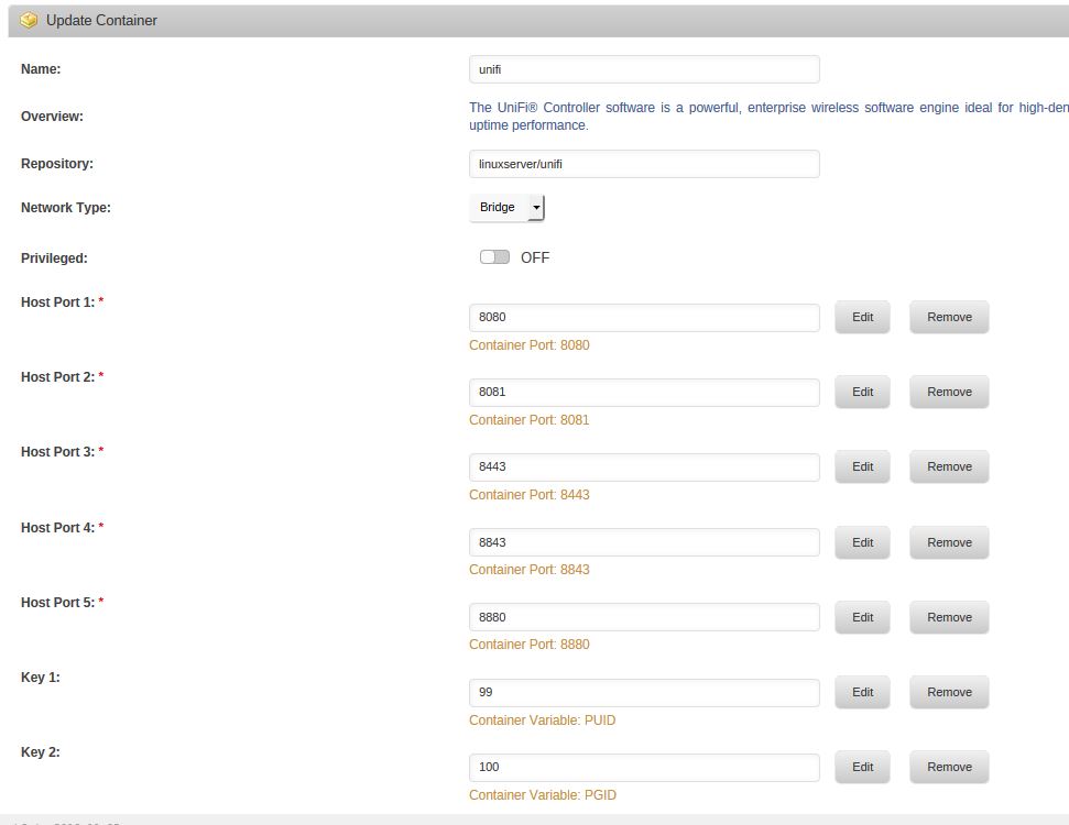

What's in the advanced section?  And what version of unraid are you on?
it's working now
unraid version 6.2.4
AppData Config Path:/mnt/disk1/appdata/unifi/  <------ that was my problem
it's working now
What was the problem?  What was it set to / what have you changed it to?
was
/mnt/user/appdata/unifi/
