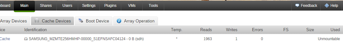

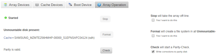

Just updated from 6.01 to 6.1.4 and now my cache disk is showing us unmountable and unraid would like to format it :(
[edit]  rebooted system and it came up with mounted cache but no data on drive, rebooted a second time and it looks like there is some file system corruption.  I can see total and used space accurately, but i cannot browse the shares on the cache.
[edit 2] rebooted again and now i can see all directories in the cache drive but not all files within directories.  some errors in syslog
Please try booting into safe mode and see what happens.  I also see that you had a failure on ata7 (device sdh).  Looks like you had a hardware issue.  I'm guessing you also had your docker loopback image on that device, which is why I'm seeing all these btrfs /dev/loop0 errors because that's for our docker image.
This looks like a hardware and/or cabling issue.
Worth mentioning that I have already powered down and checked cabling.  Cache drive is a brand new msata drive.  I have noticed in the past ata7 getting reset during power on but it has never caused any actual problems.  It just strikes me as a bit of a coincidence that everything can be running 100% smoothly then after a software update suddenly I have a corrupt cache drive
Well, it's not just a software update.  You also rebooted the host.  You also have S3 sleep installed (we don't support sleep).  Your log shows ATA7 disabled.
Roll back to 6.1.3 and see what happens.

- Replaced Sata cable to Cache drive , error in log regarding ata7 has gone away (though ive had this in the past to no effect)
- after booting cache drive appeared ok at first, but after starting docker it lost connectivity through windows and start generating lots of errors again
- removed all plugins and rebooted
- still the same
- got frustrated :)
- reverted to 6.01 all running smoothly

Just upgraded, had one small odd issue.  I have a single non ssd disk as a cache drive formatted as xfs.  After the upgrade it reset my cache disk slots from 1 to 4 and set default format of cache to btrfs.  That resulted in it wanting to format my cache drive.  I stopped the array, changed cache disk slots back to 1, and set cache format to xfs, then the array started and my cache drive was fine.
Hope this helps anyone else that encounters the same issue.
I have to agree with JonP, this is a hardware issue with the interface to your new mSATA drive.  Can you provide a syslog from your current v6.0.1, for comparison?
In syslogs, drive was setup and mounted fine, but interface issues arose.  It handles it at first, but it rapidly gets worse.  There is occasionally a BadCRC flag, indicating packets still getting through but corrupted, then afterward no evidence of packets, and even after resets, no response, so drive is dropped by the kernel (causing all the rest of the errors, including the loss of the BTRFS loop0 system on it when Docker is enabled).
Try reseating the card, perhaps it's loose?
It's very hard for me to believe you aren't seeing the same issues on all versions, for that matter on any OS you might try, because this is a hardware interface issue.  If the drive stops responding, it doesn't matter what software is loaded.  It *is* possible that one software may use different timings and procedures, trying to maintain communications with a device, but that would mean it was just dumb luck that any particular release appeared to work better.  You have indicated you saw resets before.  Those are a big problem even if it appeared to work after them, and I'm not sure I'd trust the drive if it's occasionally resetting.  Sooner or later, even in the best of conditions, there's going to be file system corruption.
I know you find it too coincidental that this happened with the update, but I have noticed that invariably with almost every update there are one or two users that find a hardware issue, right after performing the update.  It's natural then to blame the update, as it's the only thing you know of that changed.
There's a small compatibility issue with your mSATA drive, but may be harmless.
You indicated you replaced the cable to the drive, but it's an mSATA drive (doesn't have cables)?
here is my syslog after rolling back to 6.01
Some observations -
* In both syslogs, there is evidence that one or more remnants of v5 were not cleaned out, it finds an old copy of the dynamix plugin.  Please review Files on flash drive.  This has nothing to do with your main issue though, but can cause strange issues.
* The v6.0.1 system and the v6.1.4 systems are a little different, as the v6.1.4 system loads Community Applications, CacheDirs, and S3_sleep, the v6.0.1 system does not.  But this too should have no effect on a hardware issue.  It does mean though that we're slightly comparing apples to oranges, or perhaps green apples to red apples.  And I have to wonder what else might be different in the config.  You do install S3_sleep later on the v6.0.1 system, and use it.
* There's no evidence of the interface issues in this v6.0.1 syslog.  I don't know why.  There are what I think very minor differences in the kernel between the 2 versions, nothing that (I think) LimeTech would have control over.  So I don't know what to tell you yet.  I really believe you will see problems with that card.  Any chance you have re-seated it?
