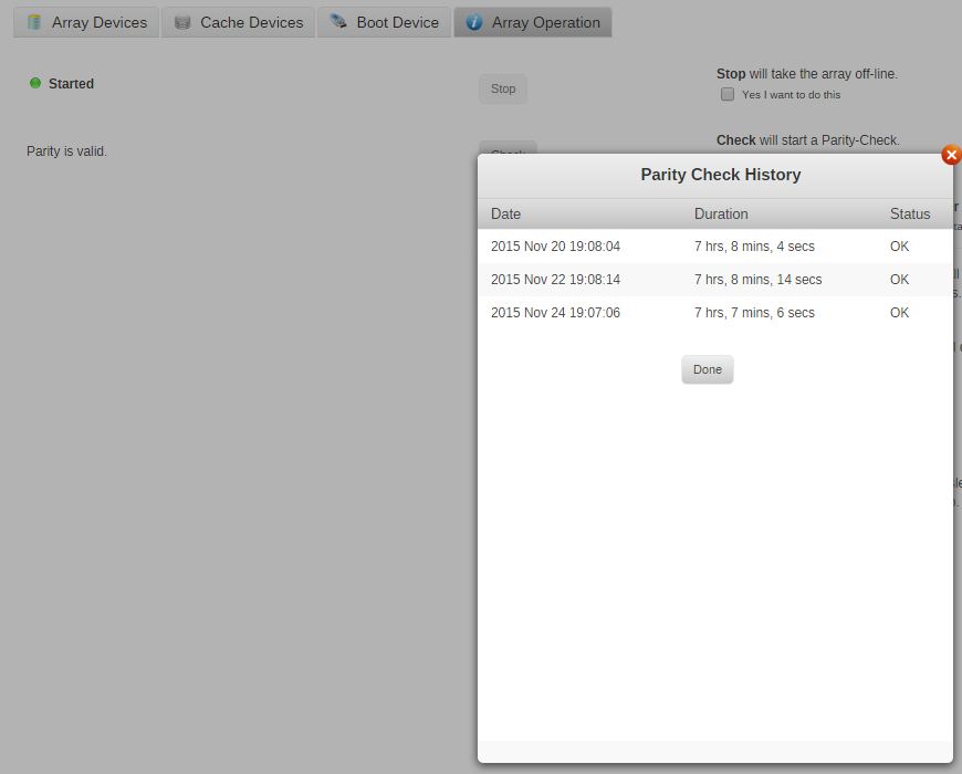

For some time unraid cant compute my parity check time and speed. There is no log rotation. Has anybody have an idea about this issue?
Can you post a syslog which has the erroneous information?
Syslog is attached, thanks for your time.

Ok, I've made an update which corrects this issue. Furthermore there is an enhancement added which stores parity check times to the flash device. This allows the GUI to remember the status of the last parity check after a system reboot (plus a history is kept).
Very nice!
Can you also store the unraid version along with the parity check times? This may be useful monitoring the SASLP issues and other parity check / rebuild issues that may pop up in v6.2

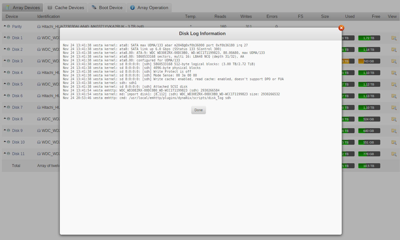

You want teasers  :D
Picture 1: a log history of each individual disk is available (soon)
Picture 2: a log history of previous parity checks is available (soon)

You want teasers  :D
FINALLY!  Awesome work
