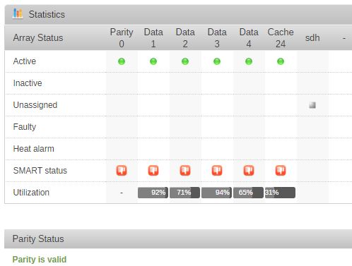

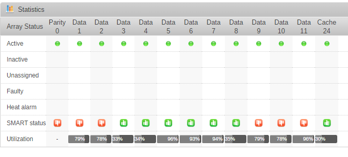

This release is showing all the disks connected to my Areca RAID card as SMART warning red. It is reading them as spun down when they are in fact all spun up.
in addition, Plex refuses to play any of my titles saying to check if the server is running. I am able to stream the MKV using VLC straight from the share just fine. I also watched a title earlier tonight (which won't play now). Diagnostics attached. Screen too.
I'm seeing the same thing.  I'm really hoping they'll add some logic to handle the Areca cards better, as they are a nice, cheap large density controller for unraid boxes.
In the attached picture at least, they do appear spun up, but Areca attached drives require special handling for spin detection and SMART access.  I suspect it is showing a problem icon when it can't access SMART.  Perhaps a third icon could be introduced, a grey one when SMART is inaccessible.
Previous version(s) just had empty space. I'd prefer that to having to mentally inventory the red icons each time to see if somebody outside the Areca is having issues. :P
ps. "special handling" sounds like the fix. Can haz?
