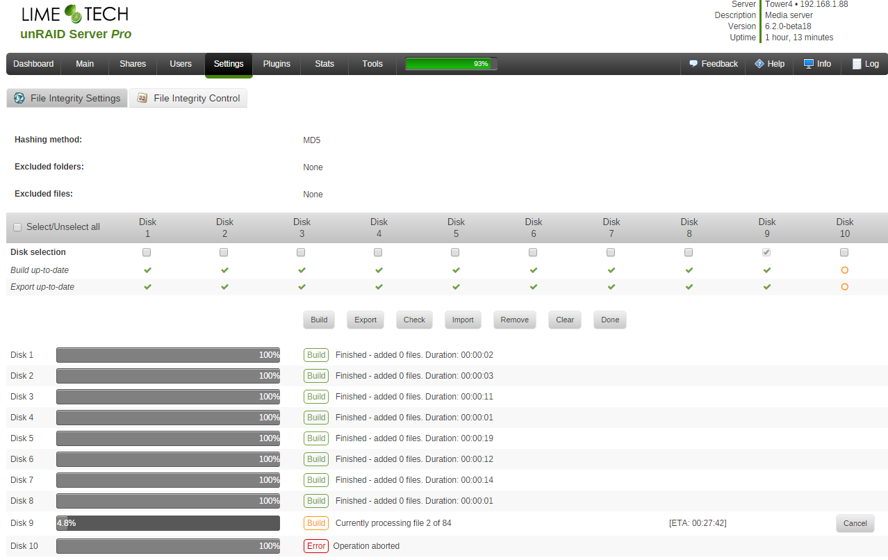

Not a very big deal but if a disk is removed from the array (disk10 in this example) it still appears on the plugin selection.
You need to redo the disk verification tasks on the settings page.

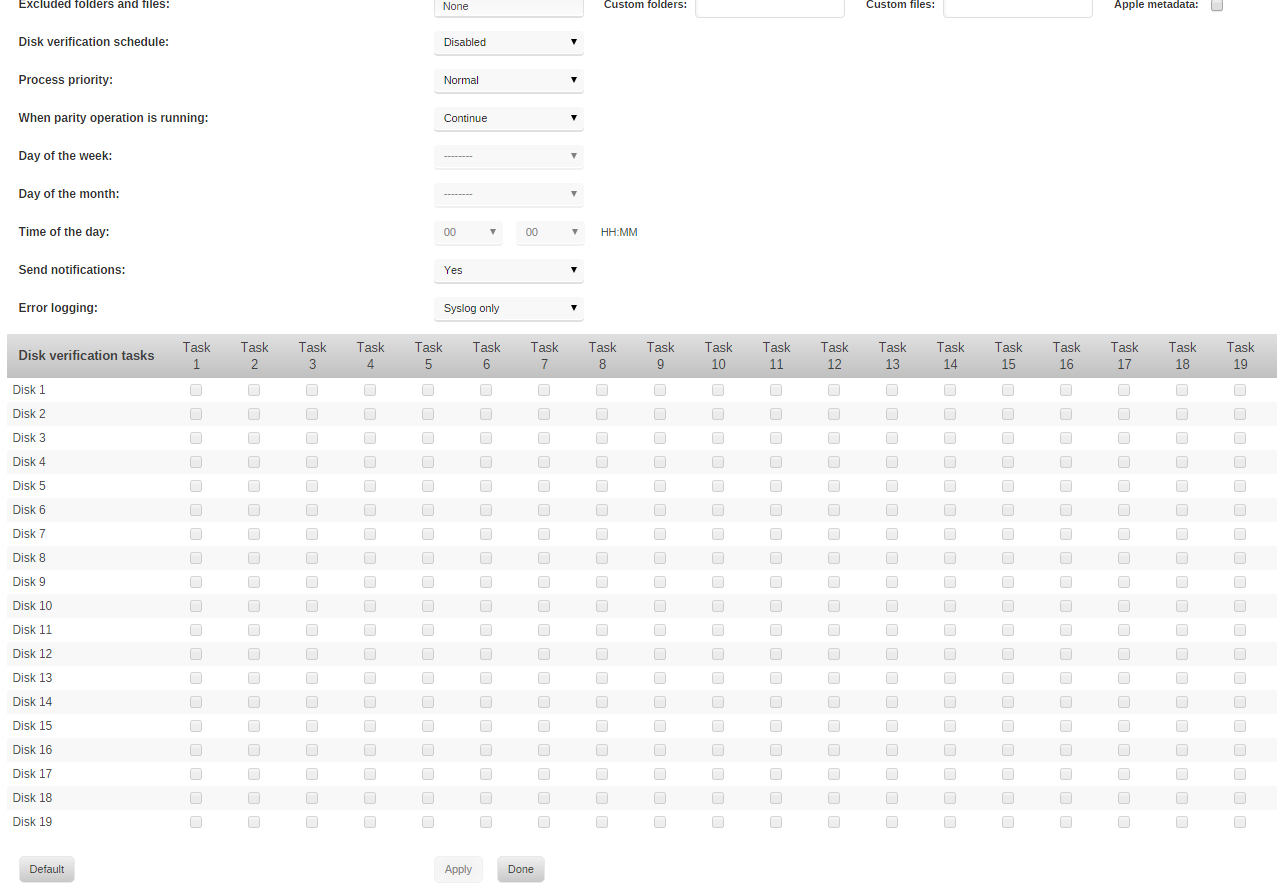

And how do I do that? This is the settings page from my test server, at the moment it only has 4 data disks.
Pressing default doesn't remove unused disks.
Hmm, in version 6.2 the number of disks presented in the array depends on the setting of "slots". Stop the array and change the slots number to 6 (if you are running dual parity).
This is different behaviour, I am going to make an additional check in the plugin to explicitely exclude empty slots. Alternatively it might be considered a 'bug' in unRAID 6.2. ::)
Changing the number of slots did it, and that’s a good enough fix for me, I was thinking the plugin was getting info from the previous array config.
Wow alright I figured it out after 60 mins of changes settings. If priority is set to "low" it doesn't start but if it is set to "normal" then it runs!
Interesting, what happens when you manually execute the command?
nice -n19 ionice -c2 -n7 /usr/local/emhttp/plugins/dynamix.file.integrity/scripts/bunker
This is what happens:
Ok, found the issue and made a correction.
New version 2016.03.20 is available. This version also addresses compatibility with unRAID v6.2. Users are encouraged to update to this version.
Please re-apply settings after upgrading to make them effective.
Just tested with low and it works. Thank you. Another question for you from your quote below. Does this mean that new files do not get a checksum or exported automatically? Meaning any new files we add must be manually added to FIP?
