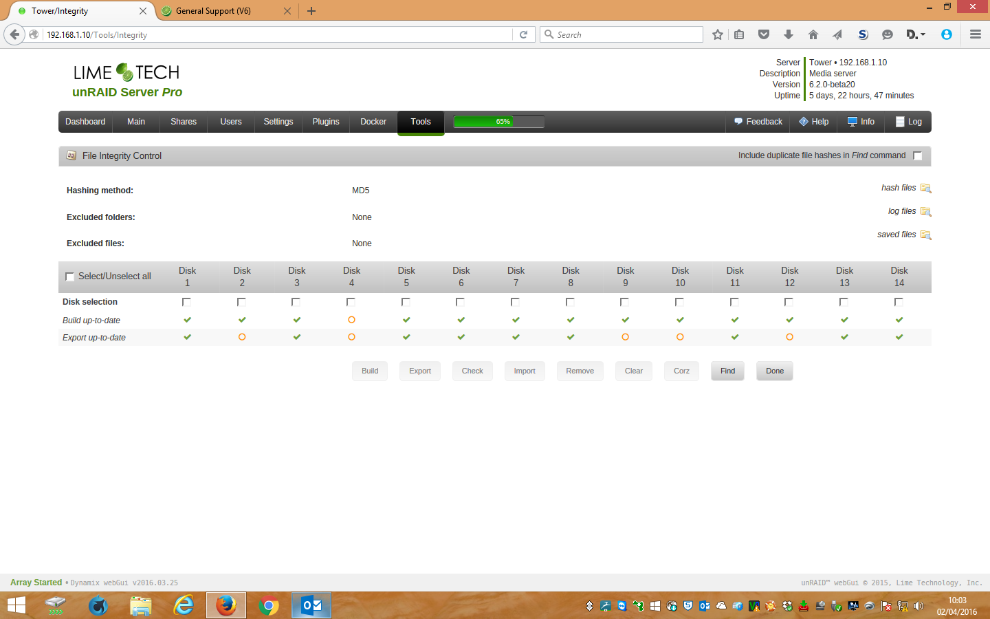

Bonienl, further to my recent post about the plugin showing that build is out of date on occassion to certain disks, despite me carrying out the initial build, please see attached screenshot.
I have updated the plugin to the latest version, and on checking have found that disk 4 is showing that build is out of date?

Any suggestions why 2 of my disks need to rebuilt every day?  Possibly I have to many files for innotify?  I have a few million files (due to plex app data daily backups)
Thanks bonienl for a fantastic plugin. I know you've made export a manual task now but is there any reason why we can't have an option for it to run once a day or so automatically? I like having an upto date listing of all the files in my array but I don't want to have to manually do it every night. Unless there's a way to add the task to a cronjob?
Now many hours later, I have just found that build for Disk 4 is now showing up to date again?

I have set the tasks to run @ 00:00 on the 3rd day every month. However on checking this morning I only have emails stating that Task 5 has started and completed? I have not had a parity check running at the same time, which could have paused the tasks
I have checked the file integrity control and file integrity settings tabs and can not see anything obvious to indicate when only one task run, or if any tasks are running at the moment?
The purpose of different tasks is to start a different verification selection each time a task is executed. Using different tasks is done to limit the load on the processor, the more disks are put under a task, the more load this will give on the processor.
In your example it will verify 2 disks at the same time each 3rd day of the month. To complete the verification cycle of all your disks it will take 6 months in total (each month another pair of disks is verified).
You can shorten the verification cycle at the expensive of higher processor load (assigning more disks to a task), but you need to be sure that your processor can handle this load, hash calculation is very cpu intensive.
Regarding your observation of build: yes it can happen that the status changes from out-of-date to up-to-date, this is because the GUI can not follow in real-time all file changes, but will eventually catch up.
Thank you for your explanation, I'll probably carry out the tasks on a weekly basis from now on.
My main concern now is the FIND feature.  This is using a significant portion of my CPU when I am not wanting to do anything with finding duplicates.
When you open the integrity control page it will start every 3 minutes a background job which is used to update the status of build and export of each disk. This is unrelated to the find command.
You can check if the background job has issues by running it in the CLI:
/etc/cron.daily/exportrotate -q
I am pretty sure I figured this out with a lot of testing.  I'm running rsnapshot sync each night to backup my appdata folder to my array.  This is not getting picked up by the plugin.  Why though.  I am not sure.  This is run directly on unraid via cron.  Its not within a plugin.  Maybe that's it?
I'm going to try excluding this folder tonight and see if it fixed the unbuilt disk.
