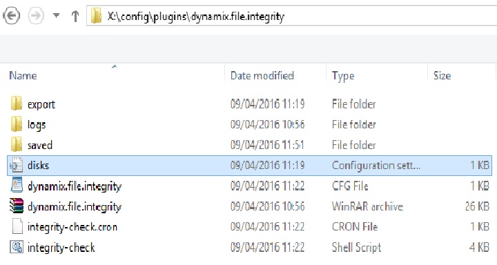

I have now rebooted the array manually, and found that although Terracopy had reported the first batch of files had moved OK to the share, they were in fact missing.
I have therefore tried to move the files again to the share, and Terracopy & Winows Explorer hang again.
On checking the log, the following entries were shown regarding the plugin after the array had rebooted. Looking back I should have got a diagnostics log instead
Apr 9 17:07:32 Tower emhttp: shcmd (122): /usr/local/emhttp/plugins/dynamix.docker.manager/scripts/dockerupdate.php |& logger
Apr 9 17:07:45 Tower root: Updating templates... Updating info... Done.
Apr 9 17:07:45 Tower emhttp: nothing to sync
On stopping the array, the GUI hung again and I had to do another manual reboot. Each manual reboot does not trigger a parity check though?
I have now started the array in safe mode without any plugins, and I am able to move the same batches of files OK without Terracopy / Windows Explorer hanging.
I appreciate that I have the cache directories plugin installed, which would kick in after a reboot. However when I attempted to add the first batch of files, this was some 6 hours after I rebooted the array and as such don't think this is connected.
