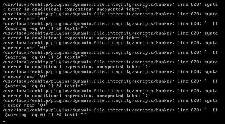

Latest verison of the plugin and 62b19 of unRAID and am getting the following spamed to the local console
Myk
Myk
Some stray characters in bunker are causing this (regression error). I have made a correction and version 2016.03.19 is available.
Please re-apply settings to make changes effective.
Thanks.
