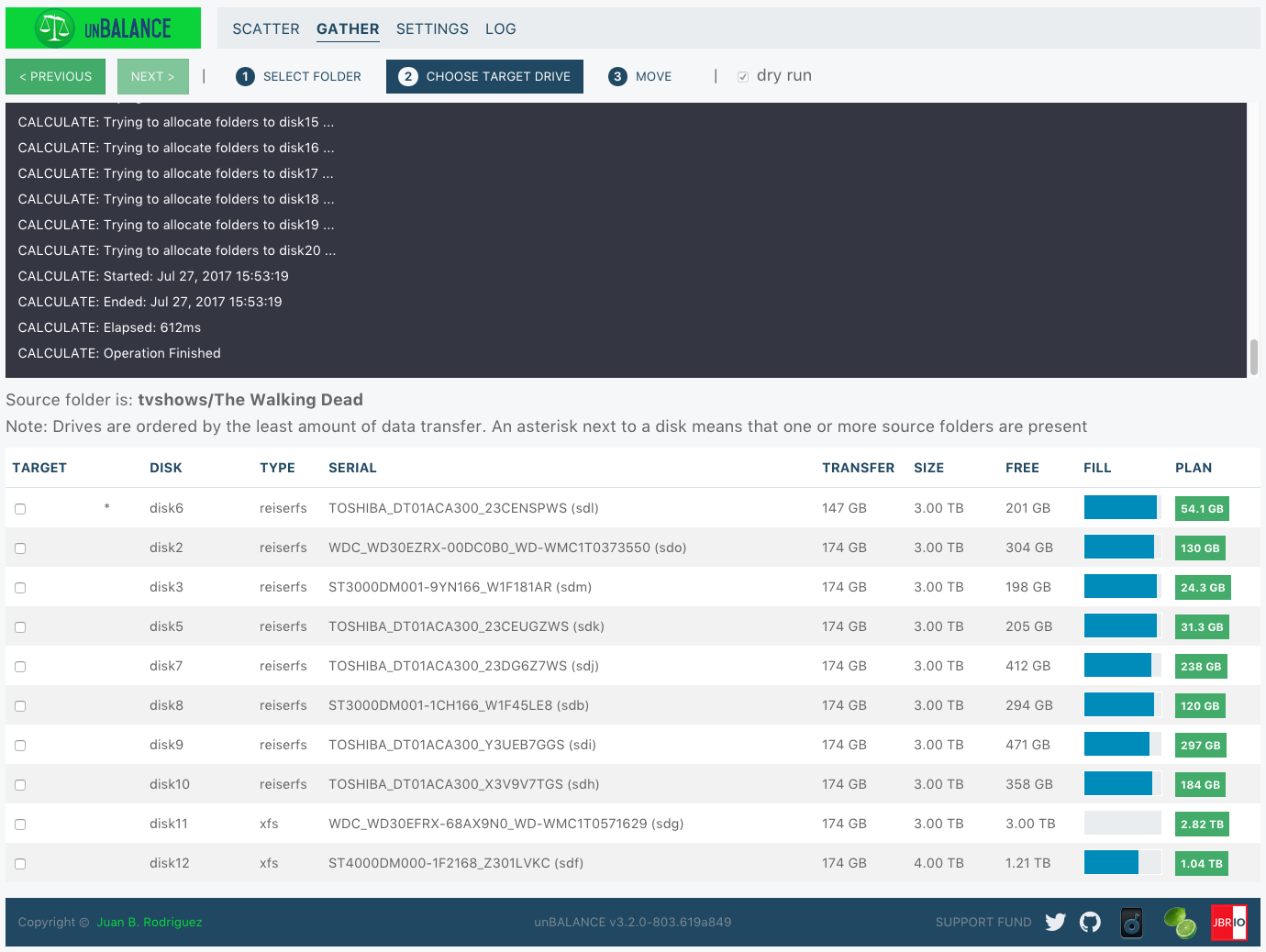

Since it's coming along pretty well, I figured I might as well post a teaser screenshot for the GATHER op :D
There's still some work to be done, but it's not that far away now !
