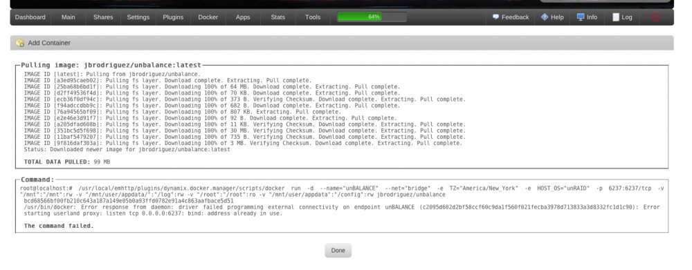

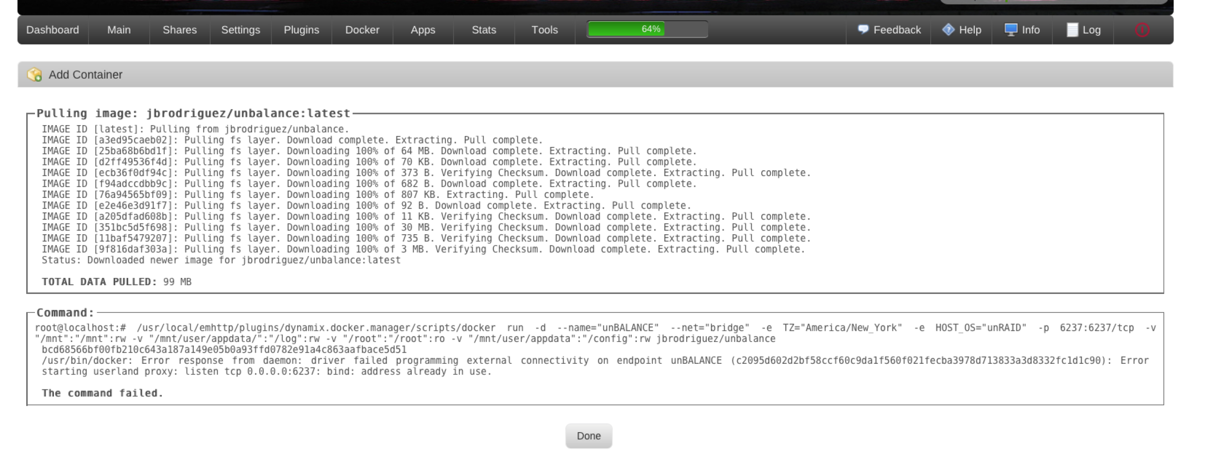

Failed install. Had to reinstall the docker but it failed.
Not sure what this is telling?
Edit: After a reboot the docker is started but now I get a message that the server is not operating and must be started. It is started though.
Edited by wgstarks
This is the thread for the unBalance plugin. The unBalance docker was deprecated. How did you even get to the point of trying to install the docker? It isn't in Community Applications anymore.
Installed it from CA Previous Apps. I guess it keeps them forever and I grabbed the wrong one.
Edge case - CA doesn't enforce blacklisting on Previous Apps just in case you need / want to reinstall it for whatever reason.  It will never allow you to install it from the available apps though....
