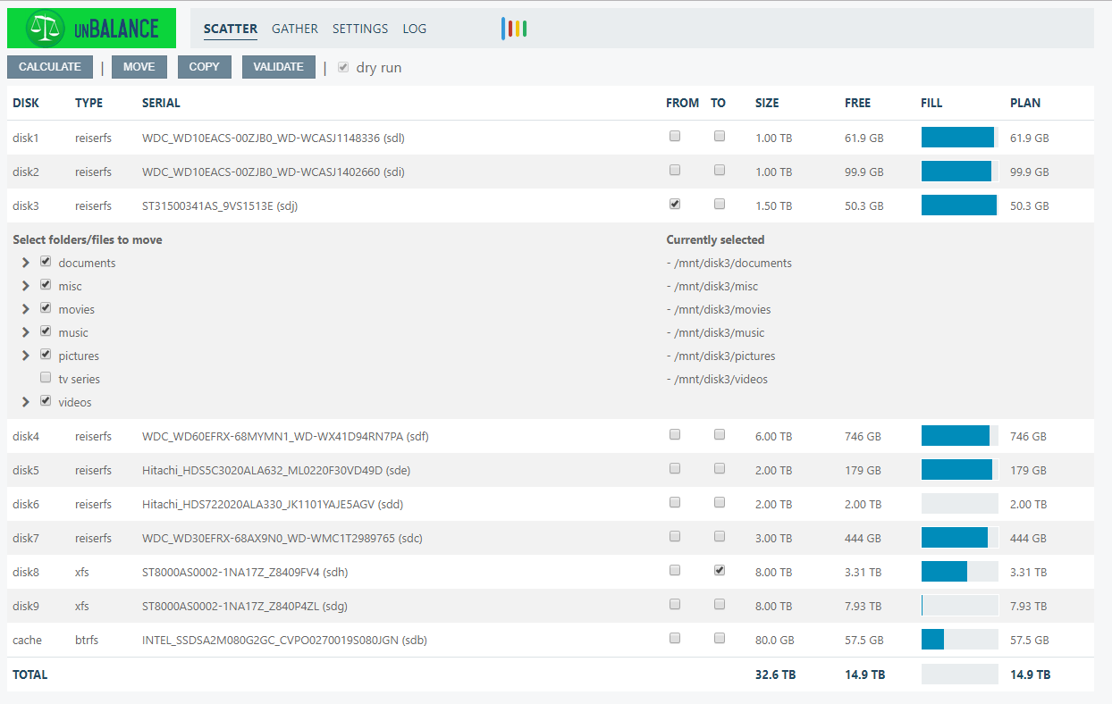

Is it possible to use this plugin to move files from a disabled disk to a good disk?
The emulated disk can be read and written just like a real disk. It won't be very efficient since all other drives are used to emulate the disabled disk.
Why do you want to do this? Rebuilding the disabled disk is the normal way to keep that data.
Thanks, that's what I figured but for whatever reason when click the CALCULATE button nothing is happening except the CALCULATE button then as expected becomes disabled.  I get no console as shown in the doc. Nothing shows in the Log page and the REFRESH button on that page is disabled. Attached is a screenshot.
The reason I want to do this is I was headed down the path of converting my reiserfs drives to xfs using a new empty 8 TB drive.  The disk 3 that just became disabled is 1.5 TB and I have space available on the 8 TB disk 8. The 8 TB disk 9 is my new empty drive.  I'd prefer not to have to rebuild the 1.5 TB reiserfs disk 3 using disk 9 but perhaps that is the best thing to do at this point and then move the data to disk 8 and start the reiserfs to xfs conversion again.  To complicate matters disk 6 was showing signs of going bad so I moved the data off that disk using the krusader docker.  Disk 6 is now empty and I would like to take it out of service so things don't become even worse if/when disk 6 gets disabled, right in the middle of a move operation for example.  I'm open to any/all suggested approaches.
EDIT, UPDATE: I turned notifications on and restarted the plugin and am now seeing the console on CALCULATE and output on the Log page so the plugin does appear to at least be working for me now.  Am still interested in general input on suggested approaches to my situation.
Edited by dabl

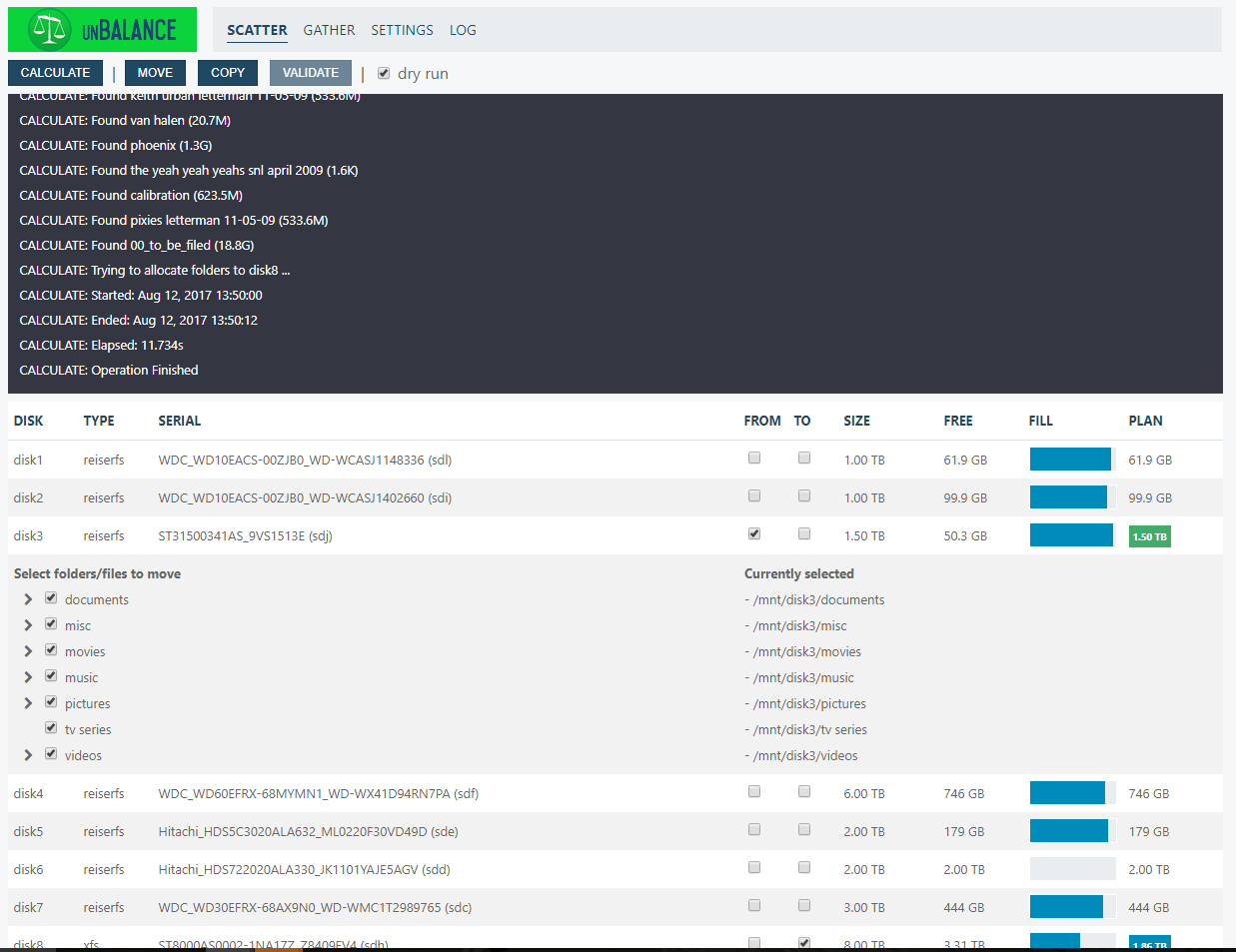

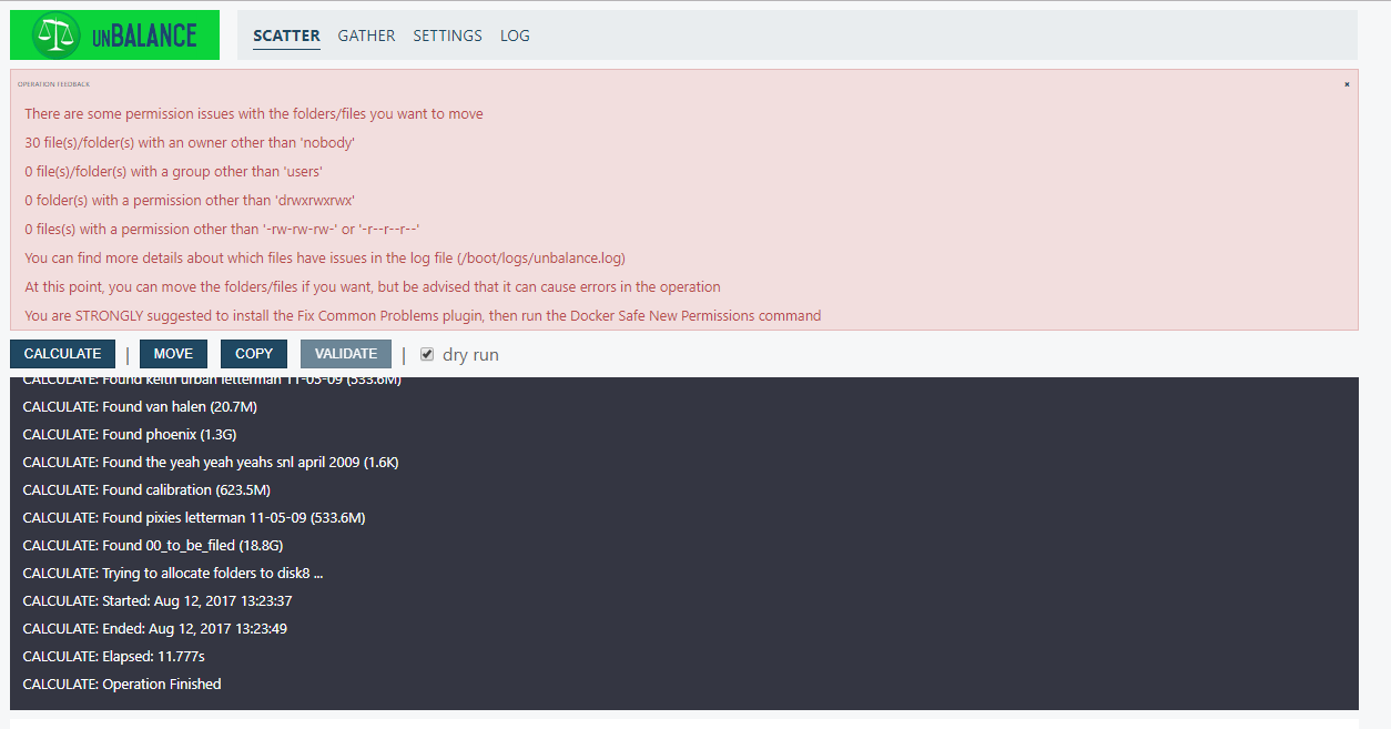

Sorry, at the time of the problem CALCULATE run I did not know to look for the log and have since successfully run CALCULATE.
For what it's worth, attached is my latest unbalance.log from a successful run after fixing some permissions on my disabled disk 3 per the OPERATION FEEDBACK screen.
Also attached are screenshots from the successful run of CALCULATE with the OPERATION FEEDBACK and the run after fixing the permissions.
I wanted to avoid any kind of system wide newperms run so ran it manually from an ssh session with newperms /mnt/disk3
After doing that I now seem to be getting a 'clean' CALCULATE with no orange OPERATION FEEDBACK screen.
One thing I don't understand is in the unbalance.log after running newperms /mnt/disk3 it still seems to be showing a (group?) [dabl] for some files but when I look at those via ssh ls -l it shows the group as 'users'.  Maybe I'm just confused on that.
EDIT: also attaching the unbalance.log generated during the run with the OPERATION FEEDBACK screen since I had saved that one.
EDIT: Hmm comparing the .log files I see the second run just got appended so that was probably uneccessary (duh) :)
Also what I was seeing with the [dabl] group was actually from the first run and was NOT in the second run......
unbalance.log
unbalance log from CALCULATE results OPERATION FEEDBACK .log
Edited by dabl

There are some permission issues with the folders/files you want to move
5080 file(s)/folder(s) with an owner other than 'nobody'
0 file(s)/folder(s) with a group other than 'users'
268 folder(s) with a permission other than 'drwxrwxrwx'
1356 files(s) with a permission other than '-rw-rw-rw-' or '-r--r--r--'
You can find more details about which files have issues in the log file (/boot/logs/unbalance.log)
At this point, you can move the folders/files if you want, but be advised that it can cause errors in the operation
You are STRONGLY suggested to install the Fix Common Problems plugin, then run the Docker Safe New Permissions command
I'm thinking it's either my Dropbox docker, or NZBget/Sickbeard/Couchpotato dockers...   I don't really know how to find out though, I checked the log and i'm not really sure what to look for.
From what i can see when I ssh to my server, some shares have folders that are owned by nobody, and some are owned by a user that i created just for myself for personal stuff, budget etc...  BUT the items that are owned by my user are nowhere near the personal folder.  I wonder if it's because I used a Windows machine to copy stuff over those shares and I might have used that username when I mapped the drive in explorer.... which would explain the ownership.
I COULD fix it with the Docker Safe New Permissions command...
Question, when you say :
You can then use the newly empty XFS disk as a target for copying the contents of one of your other disks, lather, rinse, repeat.
Once it's formatted... the array is started, but it won't part of it?  Or will it?
And how do you copy content over?  Using unBalance again?
At what point do the XFS disks become part of the array and are protected by the parity?  Once they've all been formatted?
Edited by stefer
You can copy from disk to disk using any copy tool, rsync, unbalance (which is a gui frontend for rsync commands), krusader or dolphin docker, cp command, whatever.
Parity doesn't protect files or file systems, it protects entire disks. Content and format are irrelevant to parity.
All disks assigned to data slots are part of the array, whether or not they participate in user shares is up to the settings.
I recommend disabling user shares and turning on disk shares while working with converting disks, until you understand what user shares are and how they work. Since user shares are a consolidated view of the disks, it's possible to wipe out data if you mix copying between user and disk shares.
Thanks.  I understand what user shares are vs disk shares.  It's the whole adding it back to the pool ordeal that confused me...  I'm used to my NASes and raid in general...
Using unbalance should fix the issue as long as I stop my dockers so they don't write anything new and to make sure the drive is completely empty before stopping the array and formatting.
It's funny you replied as I was reading this (one of your replies) in another tab :
Will have to run the script to fix my access rights first though...
After reading a bunch of posts, I think I will stick with btrfs...  maybe down the line invest in a good APC ups...
I have to upgrade most of my drives sooner than later anyway so I could format the new ones as XFS as I replace them.
Edited by stefer
