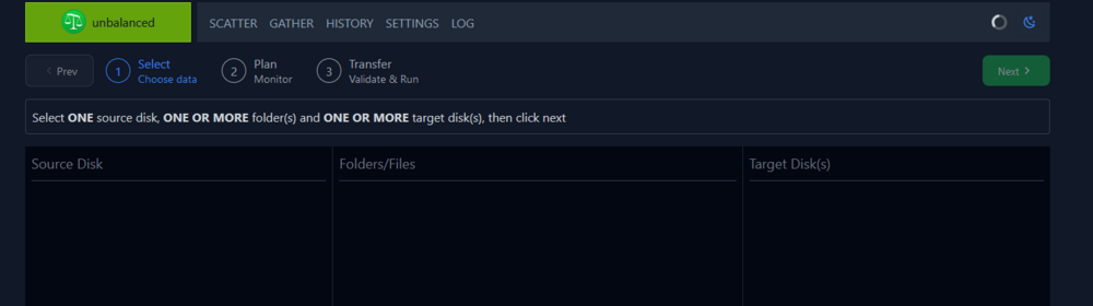

Hi, I'm trying to use Unbalanced to empty a drive before dropping it from the array to change the file system on it then add it back in. I've installed unbalanced and been able to this for a handful of drives, but it stopped working. Now when I go to access the unbalanced UI, I can pick my source disk, folders to move, destination drive, and target disks. When I then select move (dry run deselected), all the content in the columns disappeared and I have a spinning wheel up top. It's been doing that so long I can't tell if it's broken or stalled or what's up. The logs page is inaccessible and I don't see the read/write counters on my drives changing, so I don't think it's doing anything. I tried uninstalling/reinstalling it, but it made no difference. Any suggestions?

Any ideas as to why Unbalanced is doing what it's doing? If I can't get it to move the data off the drives so I can update the file system one drive at a time, I don't know what to do other than to trash the array then rebuild it with the file system I want before restoring all the data from my backup server.

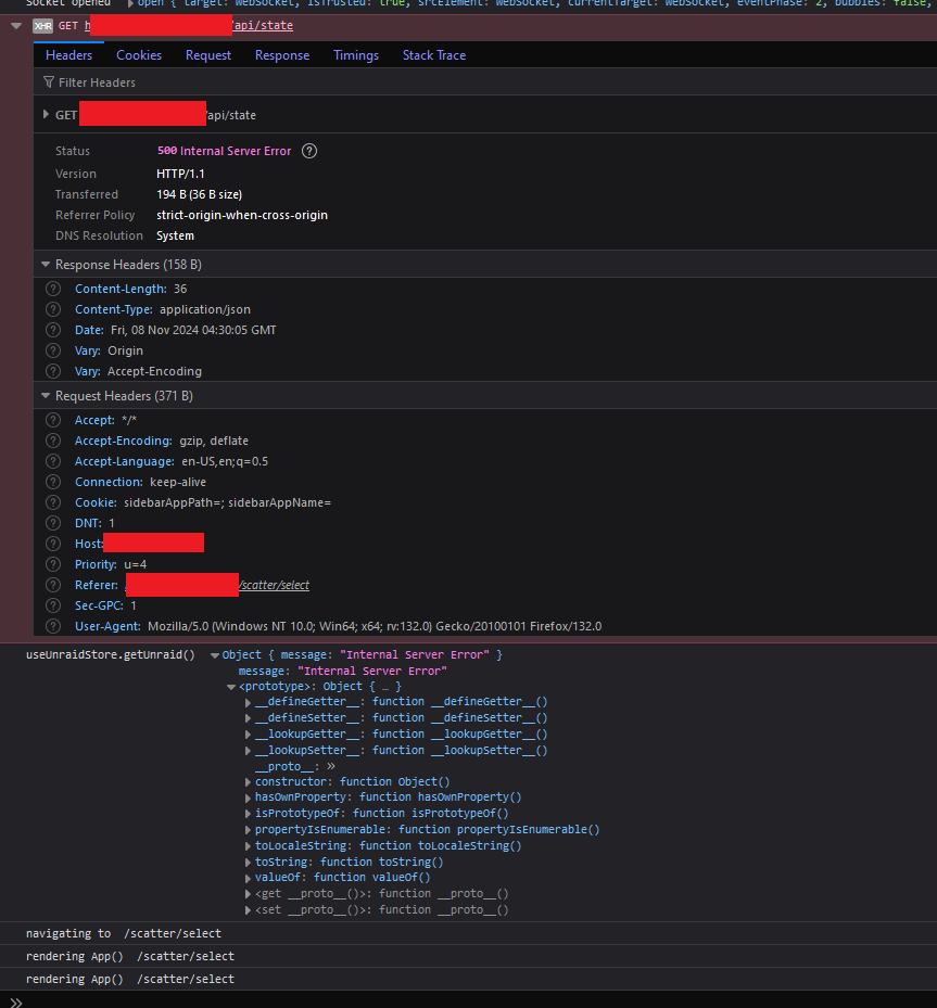

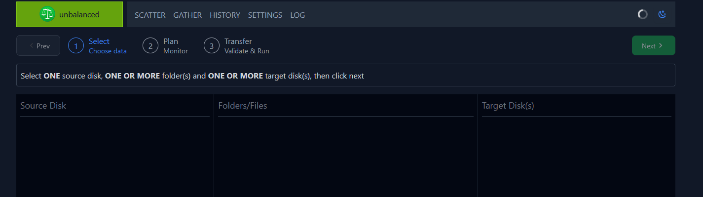

it seems the frontend silently crashed or it's really just stuck, try these 2 things
- if you're using chrome, open the developer console (View -> Developer -> Javascript Console), check if there are any errors there

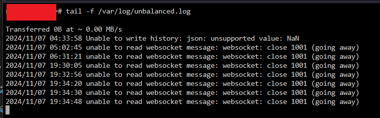

- run `tail -f /var/log/unbalanced.log` on the unraid terminal and check what it prints out
hopefully one or both of them give some clue
I was able to find errors in both. Here's what I found:
have to remove some of those frontend logs, not sure why it's logging so much 😀
the error is about the operations history, not sure what the root cause is, but try renaming the history file and see how it goes
`mv /boot/config/plugins/unbalanced/unbalanced.hist /boot/config/plugins/unbalanced/unbalanced.bak` then restart unbalanced
can you also check that file, look for anything unusual ? it's a bit dense, id like to take a look if you can send it over (dm?)
I can confirm on reinstalling Unbalanced, I see the below entry in its log before I even make a fresh attempt to clear a drive, so the history file seems to be persistent between uninstall/reinstalls:
I tried running the command you suggested from the Unraid terminal to clear the old file out of use by renaming it, but the command didn't work. Forgive my ignorance, do plugins in Unraid have their own terminal that is separate from Unraid so they operate somewhat in a sandbox environment or do I need to cd to another directory to run the command? I tried running both "dir" and ls" from the terminal, but don't see any directories listed. Linux isn't my strong suit, so thanks for the patience and help with this one :)
Edited by poshmick907ak
Forgot to include screen capture
Actually, I was able to figure out how to get to that directory, but there was no unblanced.hist file there to move or rename.
it's ok, the message is saying that there is no unbalanced.hist file, that's also why the other command i mentioned didn't work for you.
does the app work now or it still "crashes" ?
It's working now.... very weird, I don't know what changed, but thank you for the help!
