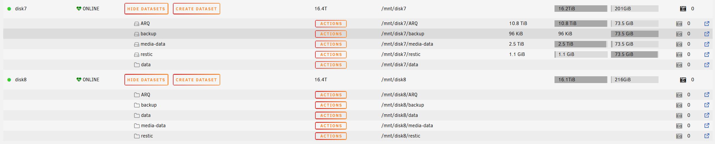

I seem to be having problems with unbalanced and ZFS.
I moved all my disks to ZFS one by one.
I did move the majority of the data around with unbalanced.
If you have ZFS Master installed you can see that some top level folders on my disks that were moved by unbalanced are not properly set up in ZFS on that disk. They are missing from the output of the command "zfs list" as well.
It looks like unbalanced does not create the top level folders in zfs as unraid is expecting it. Mover seems to do that fine.
If a top level folder was present on the destination disk before unbalance move was started, everything seems fine. If unbalance needs to create the top level folder, then the folder does not show up properly in ZFS Master.
Here is a screenshot showing the problem:
everything on disk8 and the folder data on disk7 was moved there by unbalanced.
Any ideas on how to fix this beside evacuating data each disk with issues by using mover?
