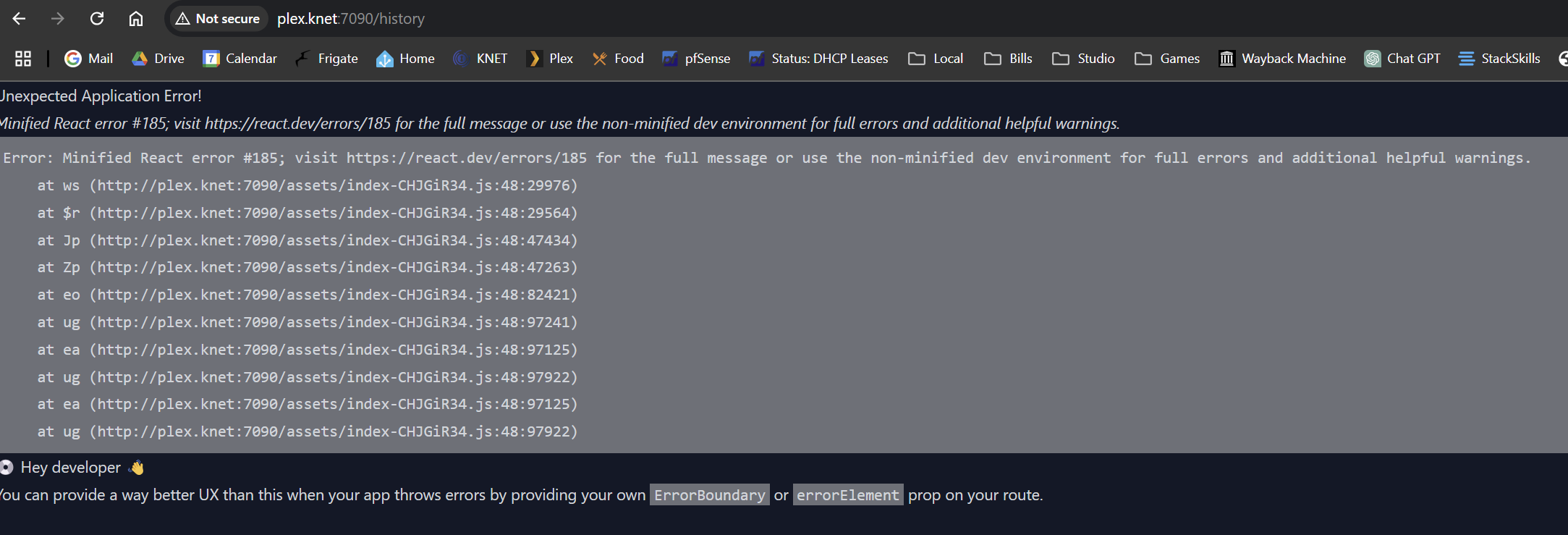

Having an issue with the History Tab this morning.  I tried moving the unbalanced.hist file to unbalanced.hist.old - no difference.  Other tabs seem to work fine.  I am moving data off of a parity emulated drive that took a crap on me, using rsync directly for time being so I can have some history to know what I still need to transfer (basically up arrow console history to review what commands I have run already).

I'm seeing the same issue with 2024.12.22 where the History tab throws the application error page. It's also occurring with Settings > Reserved Space.
For me, I see it when an unbalanced run completes. Appears to be successful, yet this error pops up upon completion.
Came to report same error
should be fixed in 2024.12.23, let me know otherwise
thanks for the reports !!!

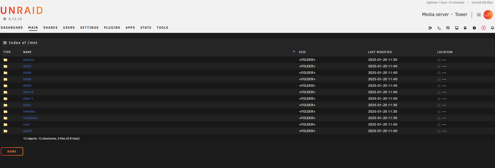

Hi all, I have emptied the disk and nothing shows up when I re-run unbalance, but I still have a parent directory showing from the main screen. Is it safe to delete this directory before zeroing the disk and which is the best way to do this ?
Thanks in advance.

On 1/18/2025 at 8:06 PM, mklecka said:
Hi, is it normal that the MOVE command leaves empty folders behind on original disk?
it could leave behind folders that had issues when moving
also, top level (shares) folders are not moved
not sure what you mean with nothing shows up
note that unbalanced won't delete top level folders, as these are Unraid shares (perhaps with some exceptions ?)
During the initial scatter operation I selected all the available folders then hit move.
After this I rebooted unraid and opened unbalance to check if anything was left behind, there were a few empty folders so I repeated the operation as suggested in the video from spaceinvaderone.
Now if I run unbalance it shows nothing to move from the disk but if I go to the main page on unraid there is still a parent directory as shown in the screenshot with 0 bytes and lots of empty folders.
I want to zero the disk as I am shrinking my array and I want to know if it is safe to delete these folders and also the safest way to do so. Thanks JB
Correct me if I am wrong but the act of zeroing the drive will eliminate all folders (overwrite w/zeros) anyway. Same with converting and formatting.
