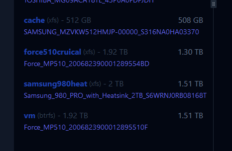

22 hours ago, jbrodriguez said:
iirc, Unraid's web ui aggregates ?
"english is not my natural language" 🙂
What I mean is that if you create a pool with more than one disk, UNRAID shows the pool name but also shows the single disks of the pool with names like "pool1", "pool2" and so on (in case it is named "pool").
But for copy purposes unbalanced should only offer "pool" (the total of all disks of that pool).
yes, that's kind of the issue :)

Hmm, it would be nice if you could focus on that "missing source pools" problem. it becomes a bit annoying over the years...

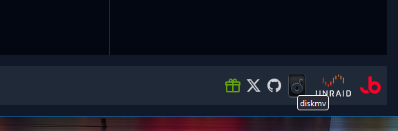

And, why does the "forum entry for unbalanced" point to "diskmv" ?
i absolutely agree with you, it's just that i haven't found a workable solution to the issue,
there's obviously a way to do it (the web ui can distinguish them), alas it has eluded me so far
i remember reading the web ui code, but couldn't quite grasp it
i'll take another stab, now that i updated a couple of things in the app
some previous versions of unbalanced (unBALANCE then) used diskmv internally, since it was a robust solution to transfer files around via the command line
i switched to rsync later on (diskmv also uses rsync internally), mainly to have more control over the rsync process (to show ui progress, etc)
i left the reference in the app, as a thank you to Freddie (fellow unraid member, creator of diskmv)
(maybe i have it pointing to the wrong url ? will check 😀)
It might not hurt trying to have Chat-GPT explain the web ui code.  You could also give it your code, and have it suggest a fix to yours to get it to behave in a similar manner.  It might not be good to rely on Chat-GPT for large chunks of code, but it can certainly be helpful in overcoming a roadblock.
that's a great idea !! php is definitely not my forte, i spend more time, checking what functions do than actually following the code :)
however, i asked for some help in the programming section here and itimpi gave me a great suggestion that i will be exploring, hopefully this will help.
i just released 2024.08.13, which should solve the pool detection issue
i don't have a zfs pool so couldn't test it, let me know how it goes
