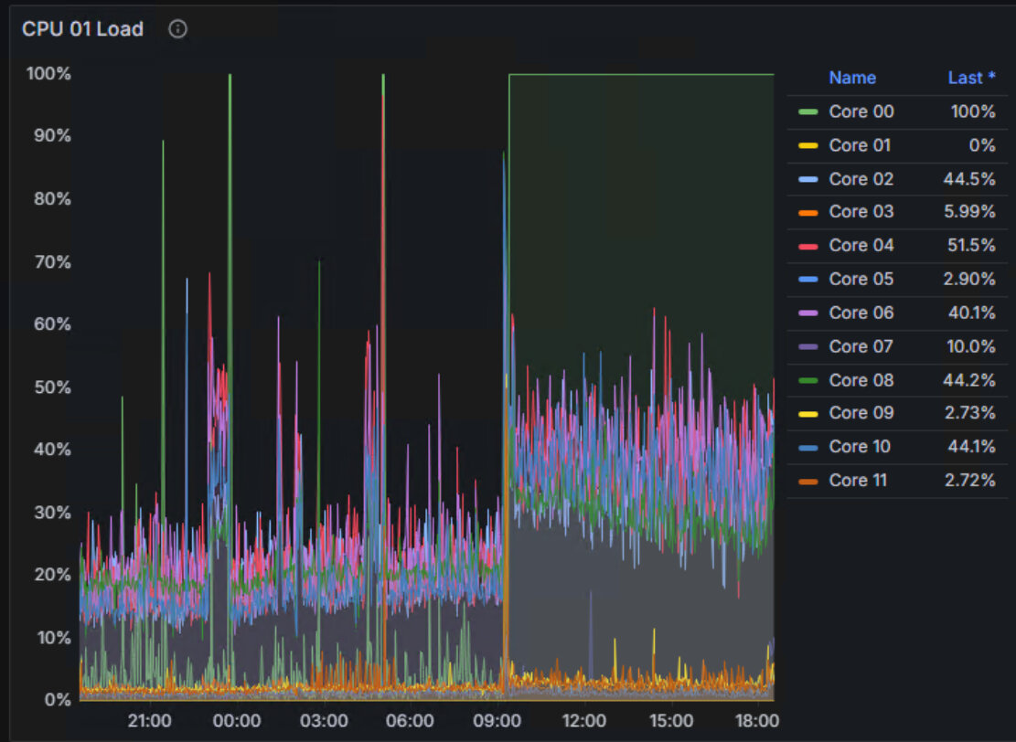

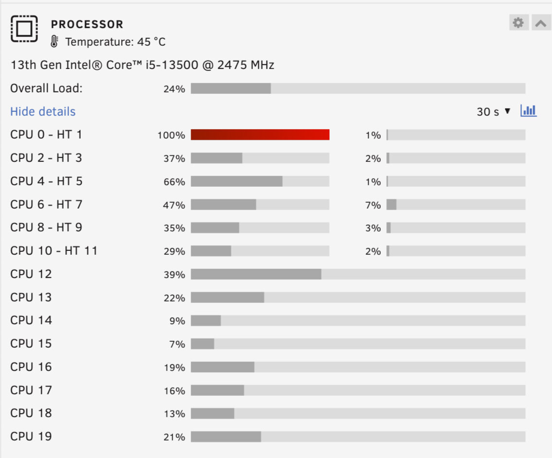

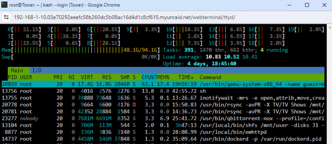

I’m getting 100% CPU usage on CPU Core0 when I use Unbalanced. Everything is working correctly, but just wondering if this is normal.
i'd say it's a bit odd, can you run  `top` or `htop` to confirm that unbalanced is the one using that core at a 100% ?
Edited by jbrodriguez
5 minutes ago, jbrodriguez said:
i'd say it's a bit odd, can you run  `top` or `htop` to confirm that unbalance is the one using that core at a 100% ?
This is where it gets weird. htop doesn’t show any cores at 100%.  I see it only in the Unraid Dashboard and in my Grafana panel (fed by telegram with out of the box CPU reporting).
