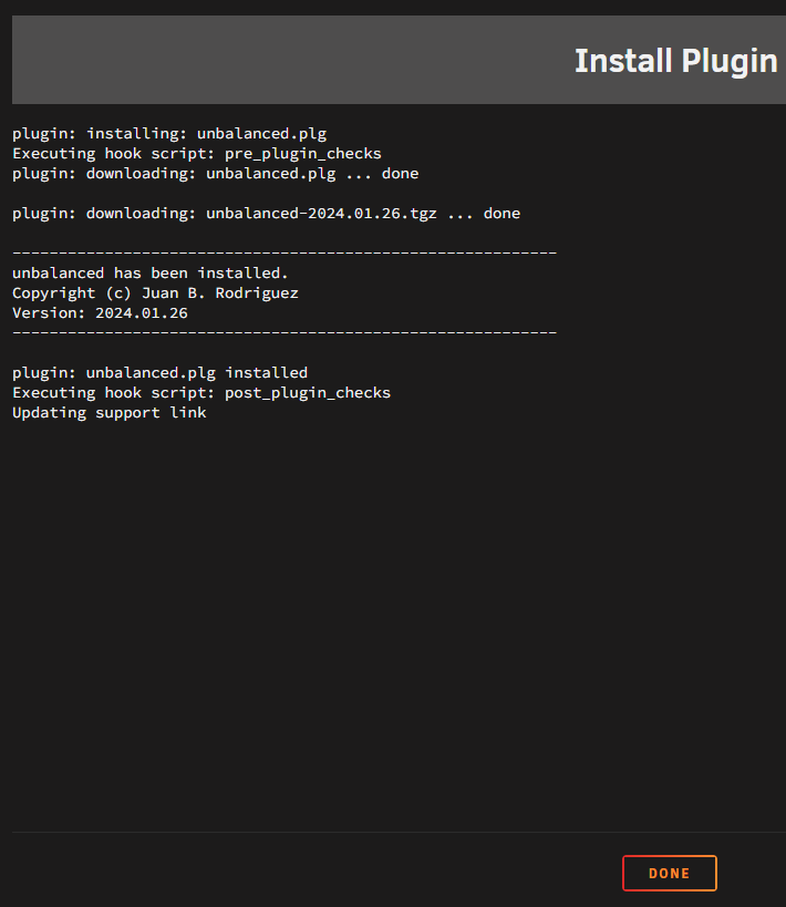

Well I cannot install, because I removed old plugin, it got removed fine, then I click to install "unbalanced" and it says "Installation already in progress" (which is not true)...
Some flag is set somewhere? Some service shouldn't be running?
no, installation should be just as any other plugin, not sure what could be causing the issue, try the latest release maybe ?
i just published 2024.01.26, which should work again on Unraid versions below 6.11.x, let me know how it goes
It was tha latest.
In any case, now the problem changed.
I rebooted the machine to see if this "already in progress" unstucks...
...and it DID unstuck! I clicked install... it said it installed fine.
...but it didn't.
I couldn't find unbalanced in the plugins!
So I go to apps and I see it still shows "install" (so it doesn't detect that it is installed).
So I click "install" again...
...and it does nothing!!!
(btw I noticed the new plugin uses a different port and that different port is not even configurable? So how does it know that there is no conflict???)
Remember I use UNRAID for years and I have numerous plugins and containers and VMs on it.
At this point I cannot reboot the server again, maybe within the weekend. Any ideas?

On 1/26/2024 at 6:48 PM, NLS said:
It was tha latest.
...but it didn't.
this is definitely strange :), what if you go to the Unraid Settings page, at the bottom it should show the unbalanced plugin
the port is configurable in the unbalanced plugin page
also, although not ideal, can you try manual installation: in the Plugins page, you can try manual install tab then paste the plugin url https://github.com/jbrodriguez/unbalance/releases/latest/download/unbalanced.plg
I've been using UNRAID for years. I see that it is not installed.
Anyway, using the direct URL also did nothing (!!!)...
So I rebooted the server once more.
I will try again from apps and see what happens:
...and yes... now I HAVE unbalanced and configured port and enabled it!
Nice blue interface.
yes, i remember your nickname from the early days 👍 !
nice that it worked for you, thanks for the kudos !
