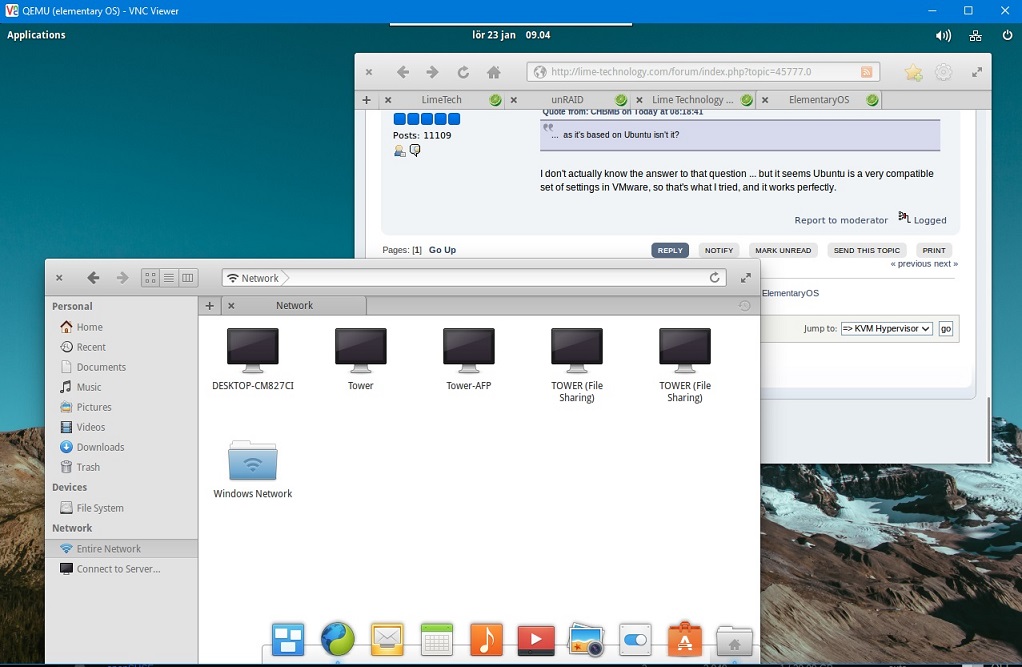

I have had a few hurdles with ubuntu desktop vm: login display rendering, mouse loosing ability to click via web VNC viewer, long-term stability lockups.  1 week in and ZERO issues with elementary so far :)
Both are setup to have 1 core and 4 GB of ram with the user shares passed through directly from the host unraid (tower2) and user shares fstab mounted from Tower1
I've just set this up (as CHBMB's xml), but the VNC experience is awful with display rendering and mouse lag. Set with 2 cores and 4gb ram.
Has anyone else experienced this?
Every once in awhile, but manually resisizing the remote desktop window via drag always fixes it.  Using emulated GPU, not pass through
It's strange as the login screen is perfect
Also ensure that you set your elementary is resolution so that your not having odd scaling
Thanks, change of resolution and reboot sorted the display issues,resizing the VNC window fixed the mouse lag.
Quite a nice OS!
Yup, setting resolution means you are not having odd scaling issues... Should be fixed for good.  'Mouse lag' always self fixes with a quick manual resizing of vnc window.
