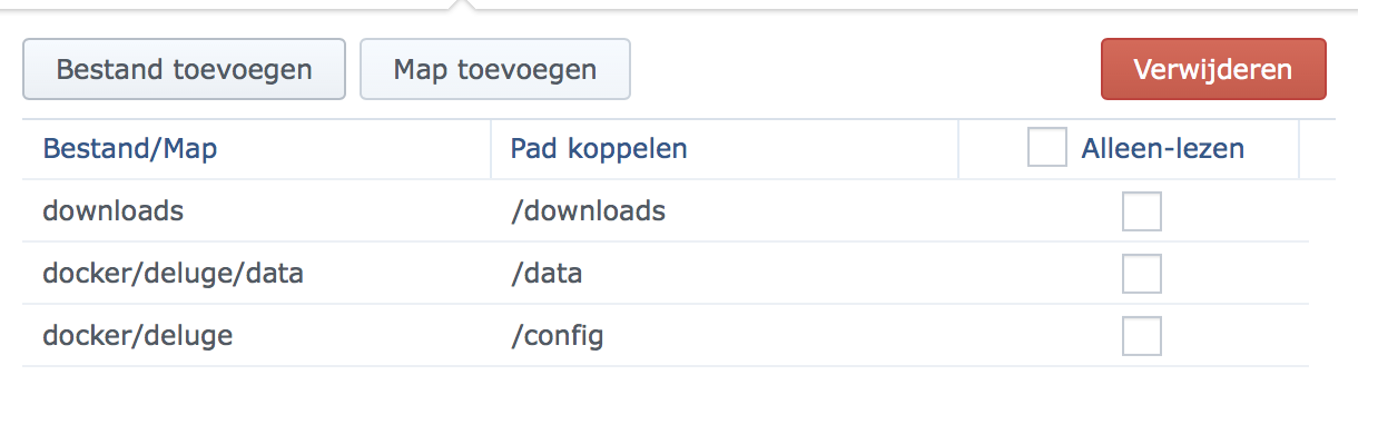

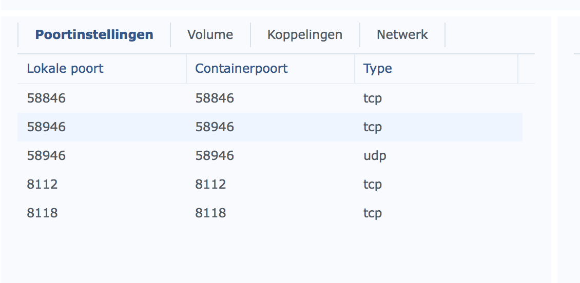

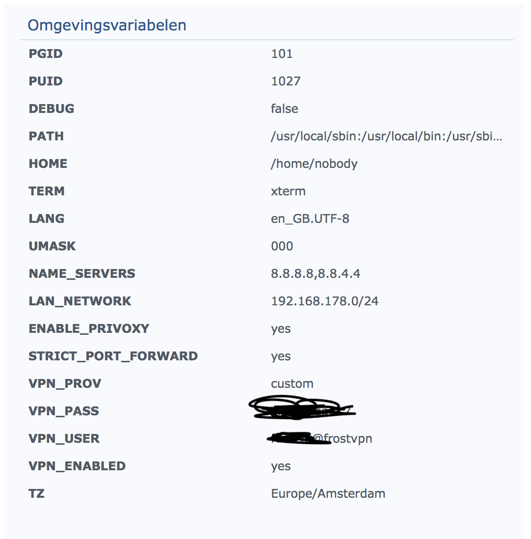

I've been trying to get it to work, it seems to be running. But can't connect to the webgui, I seem to be missing something trivial probably.
Hope you can help! I attached some screenshots of my Docker container on DSM 6.1
My local NAS IP is: 192.168.178.24
Regards,
Justin
Regards,
Justin

Have you added the port when you tried accessing the WebGUI?
http://localhost:8112
I used the IP of my NAS and tried to access: http://192.168.178.24:8112 but that doesn't work
