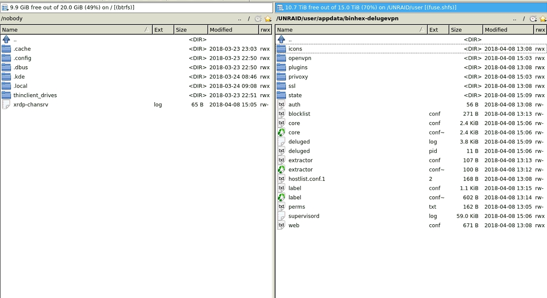

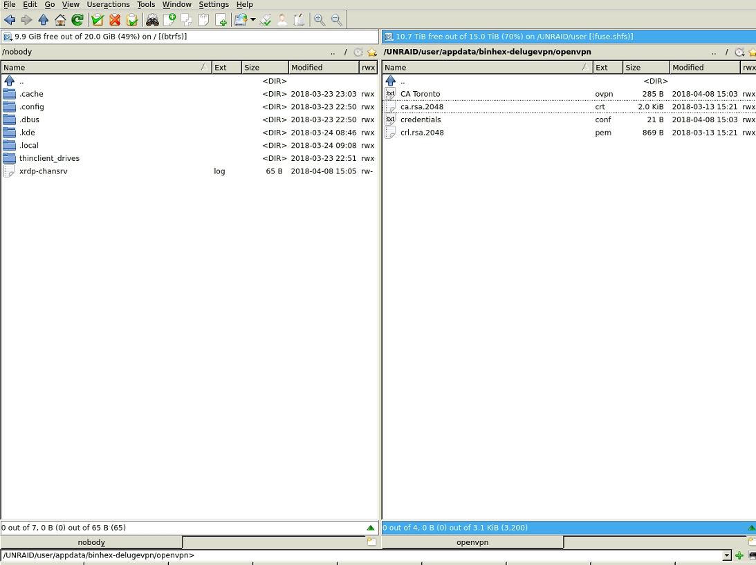

attached are 2 screenshots showing my directories and i definitely have the folder and definitely have the files in there and please forgive my ignorance im not sure what you mean by post 2
@wgstarks didn't read the whole log, he was just seeing the top part. :P It all looks good from here :)

Quote from the log you posted-
2018-04-08 13:05:25.923622 [crit] No OpenVPN config file located in /config/openvpn/ (ovpn extension), please download from your VPN provider and then restart this container, exiting...
The docker isn’t seeing the openvpn directory. I would suggest deleting and installing a new one. The instructions for downloading the openvpn folder from PIA are in post number 2. That is the second post in this thread.

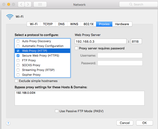

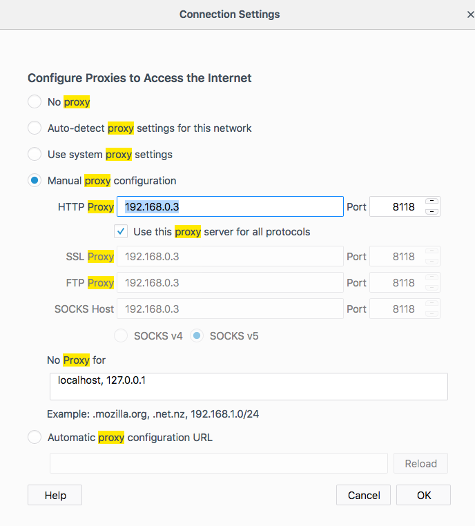

13 hours ago, Chamzamzoo said:
Proxy doesn't appear to be working again, any ideas?
Downloads have the VPN IP but proxy just goes straight through to my ISPs IP.
supervisord.log
nothing wrong in that log, you must not be pointing your browser at the proxy in that case, privoxy is a solid bit of code i am confident your issue is misconfiguration somewhere. so to confirm are you attempting to use a browser to confirm privoxy is working?, if so what browser?, also can you post screenshots showing the configuration of the proxy for your browser.
Edit *** it's just started working again ***
After your reply I can see that your Deluge docker is working properly, but my system settings are not being respected by the browsers, despite being told to use system proxies in settings (chrome and FF). When I put the proxy into Firefox directly, it works, but when set to system settings (and proxy applied to the wifi device) it doesn't work. It has worked like this before. Weird!
My dockers use it also (sonar etc), and for a time they were not getting any data through for searches (how I noticed the problem). They are now (not sure if I can check over what IP though).
Edited by Chamzamzoo
