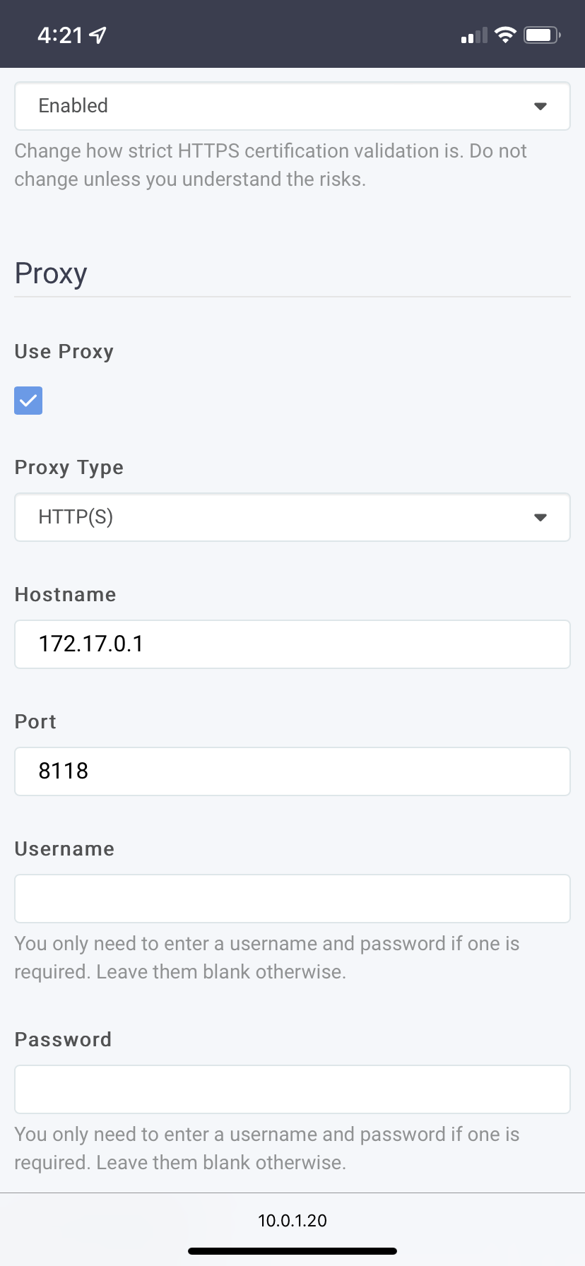

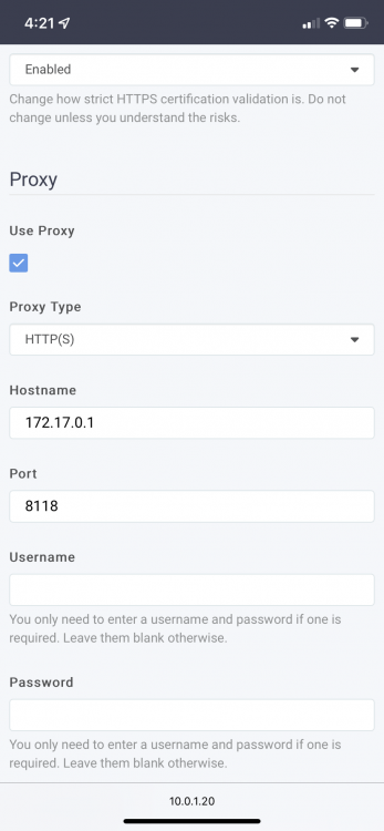

Currently using delugevpn and sabnzbdvpn running and both have mullvad vpn set up using wireguard. They both work great and i'm happy with it. I would like to route firefox, sonarr and radarr through delugevpn or sabnzbd using their privoxy but cant get it to work. Any tips please !
What are you using for the IP?
I'm using this
Here are rest of my settings
Try this-
Edited by wgstarks
18 minutes ago, wgstarks said:
Try this-
No luck unfortunately.
You had it almost right in your last post. The port is wrong, should be 8118. So change the port and change the IP back to the 198.... IP
Yes sir that worked !! Thank you !!!!
